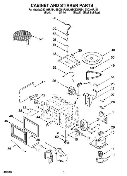

control indicator light shows micro door is open - when it is closed. Is this the switch. Please send part # and diagram to install..
Number 51 are the switches that are suspect. They may be tested with a meter for continuity, if you have one available. The switch is available below.
