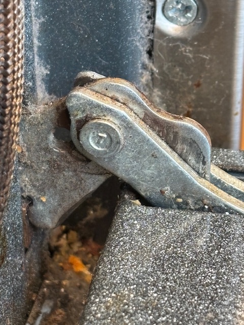

I need to replace one of the glass panels in my oven door. However, I can’t figure out how to remove the door as the hinges don’t contain the flip-over locks shown in almost all the videos I’ve seen, nor do I see any holes in the hinges into which door removal pins (or nails) can be inserted.
Brand: KitchenAid
Model Number: KEMS378GSS0
Main Symptom: unable to remove oven door
If the door is opened to a 45 degree angle, it should be able to be rotated up while pulling away from the oven.
When opened 45’, there is no “play” at all. When opened maybe 30’, there is some vertical play … but try as I might I cannot manage to get the door to move “out” – i.e. away from the oven cavity. Here’s a picture of one of my hinges:
Any other ideas?
A nail or other item can be placed in the port just to the left of the hinge pin as seen in the image.
Tried that – and the nails do stop the door from closing more than 45’. But, I still can’t get any “in and out” motion – and barely any “up and down” motion. Maybe I need to enlist a second pair of hands …
If both hinges are blocked with pins or nails in the ports, it should rotate up towards the oven a little bit and then pull out while slightly lifting, based on the hinge type. As seen in the link, it utilizes a hook design at the tip. WP4455525 Oven Door Hinge | Genuine Whirlpool OEM In Stock

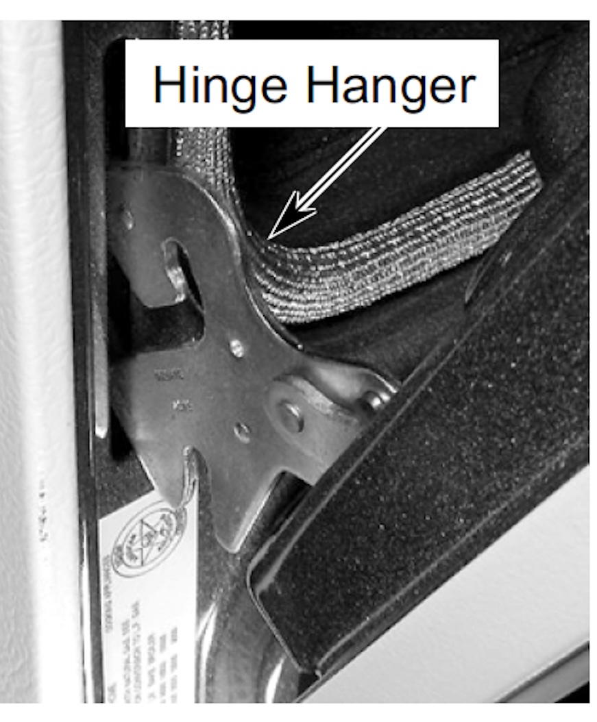

Still not working … perhaps because my hinge is of the type shown in this picture taken from a KitchenAid “Technical Education” brief that supposedly covers my oven:
Note that piece that goes into the body of the oven is dramatically different than WP4455525. Unfortunately, I can’t find a part number that matches the above picture.
Update: Got the door off with the help of a second person – to manipulate the nails I was using as door removal pins so as to allow the door to close a bit further while still attached to the oven. And, indeed, the hanger looks just like that for part WP4455525 – which doesn’t bode all that well for the applicability of the remaining instructions contained in the technical brief I alluded to previously!
