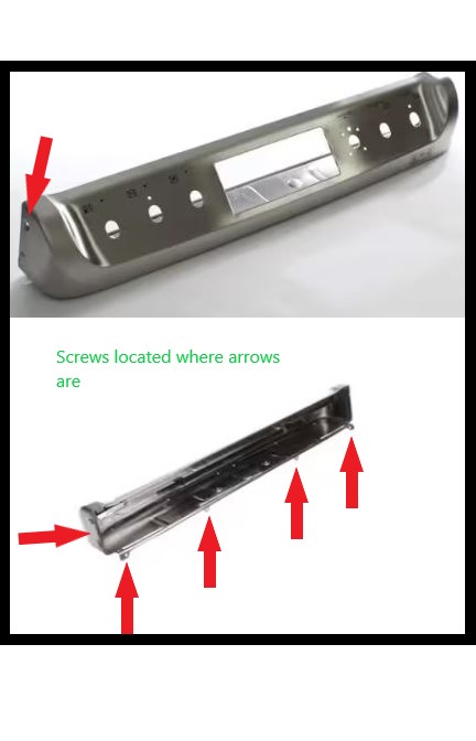

Main Symptom:trying to remove front control panel
What happens & when: LCD panel is loose behind metal frame
See the attached diagram for the screw location to remove the control panel.
https://www.appliancepartspros.com/controller-parts-parts-for-lg-lsg4513st-00.html
@Jgadebusch Here is your service manual.https://research.encompass.com/ZEN/sm/LSG4513ST.pdf
