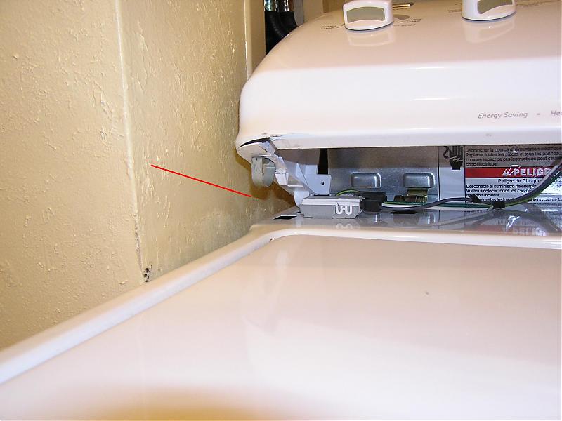

I believe my pump is leaking and went to replace but I am having a heck of a time figuring out how to get the cabinet (outer cover) off. I’ve reviewed many of these threads and they talk about the screws on control console and or they may be hidden behind plastic covers. I have neither on this machine. Is it a newer model with a different set up to remove the cabinet? I’ve tried everything I can see without starting to break things. There do appear to be some plastic hinges on the back side that seem to hold the panel but I can’t see how to get that panel loose. Is that the first step in repairing a pump on this model??

if its the newer style there are no screws to lift up control panel.there are hidden clips under panel on left +right side, i use aputty knife to push +lift. a real pain. then there is brass coloured long clips to be pulled up with screwdriver under clips .then remove wire harness, +pull shell forward +off. feel under pump to see if it wet, that means leak +replace pump

Thanks a bunch, that was the trick. Actually the putty knife under the sides worked fairly easy once I knew where to pry it up at. I had tried that earlier but it sure seemed like something was going to break.

See attached picture for detail of console and clip to pry with putty knife. One on left and right side.
