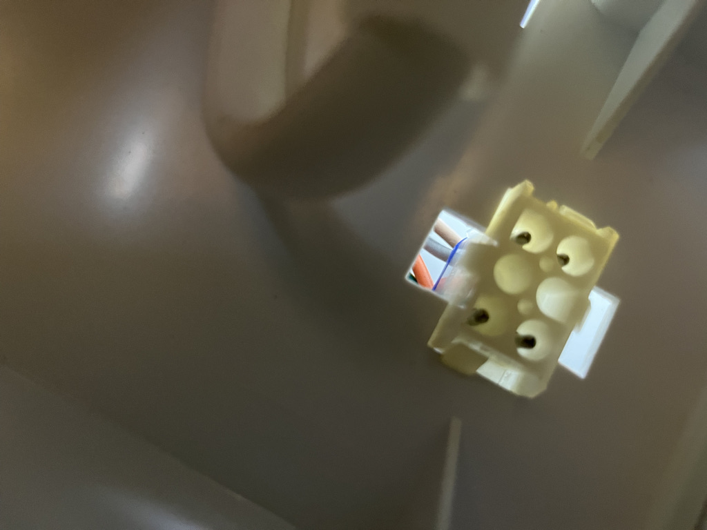

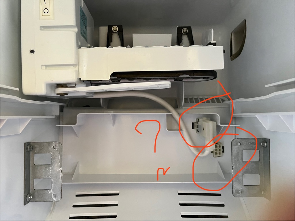

Installed new evaporator motor. In replacing auger motor and icemaker… I would like to know which connections are correct. Perhaps a wiring diagram would help? if i looked at the colored wires???

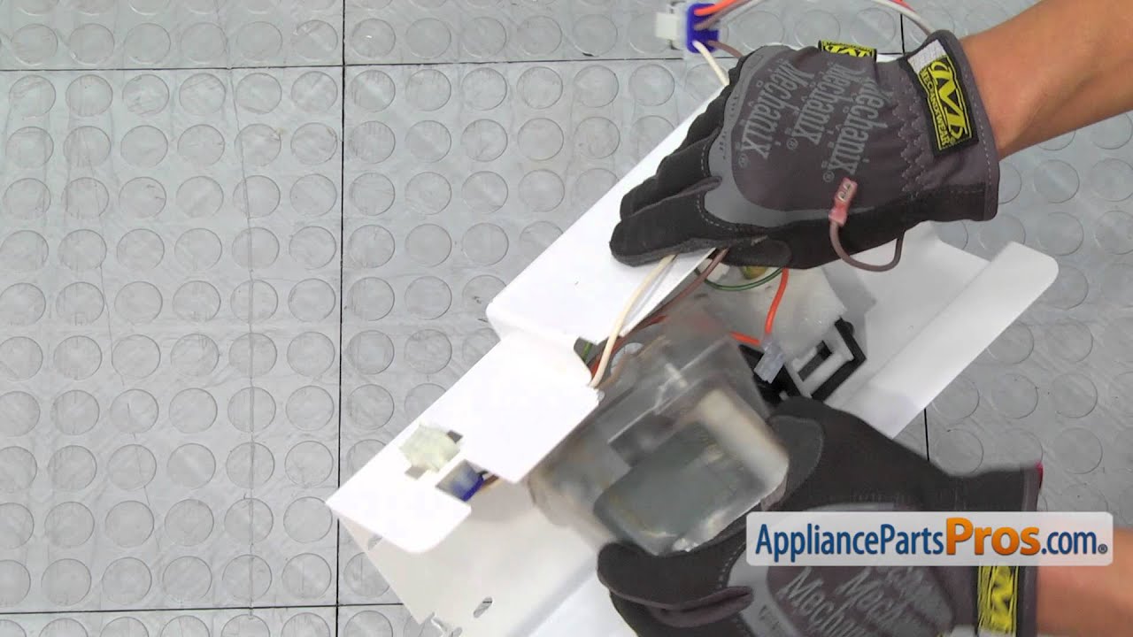

Installing a part like the auger motor can be tricky, especially when it comes to wire placement. Typically, the orange wire connects to the top terminal, while the other wire goes to the bottom.
This repair video provides a helpful visual reference:
vs the ice maker wire colors? On my model there are two holes next to one another on the right side in the auger housing cover. I know the connectors only connect a certain way, but my bigger issue is I wasn’t sure which slot of the housing to put either connector. If i put the icemaker in the top slot, then i just want to confirm it is not the auger connector, etc.
In these picks, I did connect the icemaker…HOWEVER that is my question if it is right. The view of the open connector with light on the wires…is that the auger motor? I don’t know if i plugged in the wrong connector to icemaker
Based on the wiring diagram, and the images provided, the lower right connector is for the auger motor harness.
