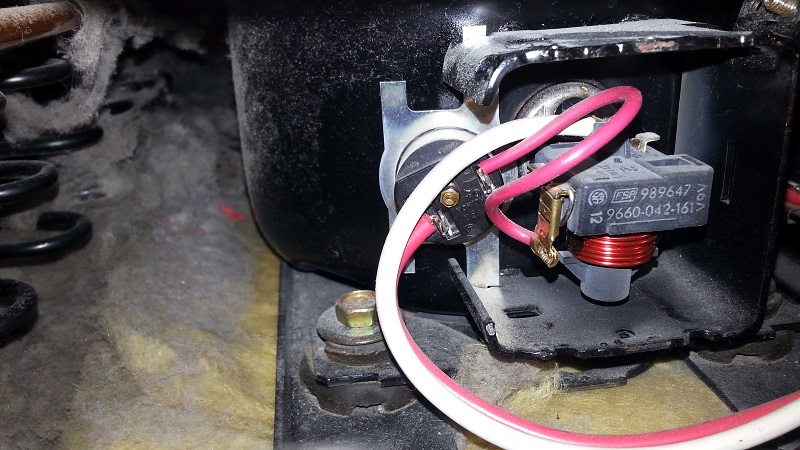

When starting the fridge on generator power the fridge fan turns on and I hear a relay click and 1 second later unclick but the compressor doesn’t get running. The cycle repeats every 30 seconds or so and I stopped trying after the 4 retry to let things cool down and avoid damage. The voltage drops from 120VAC to 95 when the compressor tries to start with no other load on the generator using a 12 gauge wire to power the fridge.

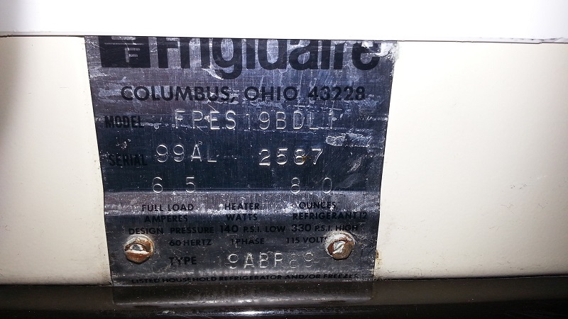

Going off the fridge ID plate, I see an 89 in the model number. I think that is generally about when the fridge was purchased, 1989? or roughly there about at least as we recollect.

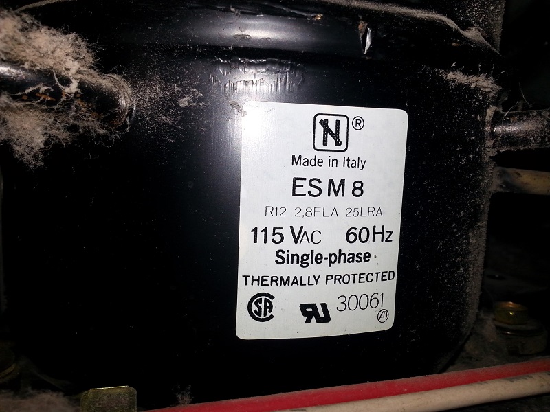

Compressor info:
Made in Italy
ESM8 R12 2,8FLA 25LRA 115 VAC
60Hz Single-phase
Thermally protected
30061

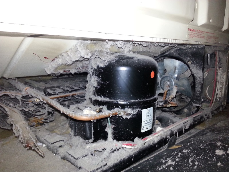

I’d think that if you let the pressures in the system equalize, your compressor may be able to start on the generator. You’d need to unplug or turn off the fridge for 15-20 min to allow pressures in the system to equalize, so the compressor overload doesn’t stop it. The overload is there just for that reason. The overload will trip as many times as it takes to start the compressor. The compressors are not powerful enough to start against the pressure in the high pressure (hot) side.
If you were to unplug it from the wall while running and then plug it back in quickly you’d probably trip the overload also; depending on high side pressures and how fast they drop as the refrigerant seeks equilibrium.
Try it after it’s been off for 15 min and see if it starts. Also try measuring the amp draw on the red wire at the compressor at that point. If it is truly drawing 19A at 120V that is a new record for me.
Unless you live in a very hot climate or keep the unit relatively empty you may not need to power it continuously to preserve temps in a short outage. If you do not open the door frequently and have a full load you can probably get away with only letting it run to temp 3-4 times per day for several days. You can help it by filling free space with water bottles or anything that would help keep temps stable while the machine was off.
Oh and clean that condensor!

I will clean up the condenser :slight_smile: I did clean it from the front side about a year ago, never removed the back panel before so that area was neglected.

The condenser area is very clean now with all most all dust removed. I’m noticing though this weekend that the compressor is pulling 22.5 amps on every startup now, running amps staying the same 2.5. Even if i do a 30 min, 1 hour or 2 hour off period before startup the amp draw is now 22.5. So why did the amp draw increase from 19.5 to 22.5.
Can a old worn klixon relay (PTC? compressor start relay) increase amp draw?

So I bought a Supco Hard start relay 1/3-1/4 HP to match this compressor HP.
After installing it the startup amps went down a little from the 19-22 amps startups to roughly 16-18amps startups with the relay in place.
I figured it still wouldn’t start on my generator though unless it was on the low end at 16 amps…
I setup the generator and tried the fridge with the hard start relay.
Tried multiple times and each time it started right up! I was rather surprised and then more surprised to see it was only drawing 14-15 amps each startup. I figured the amps wouldn’t change with shore power vs home generator…not sure what caused that. Voltage which i monitored didn’t drop more than 10 volts during startup, vs without the hard start relay voltage dropped a lot lower.
Anyways great success as a project trying to troubleshoot this for fun and to now know that the generator could power the fridge if need be.
I’ve removed the hard start relay and put the old PTC relay back for the time being though.
If anyone has an idea why the amps dropped that low vs the amp reading with relay on shore power let me know? Could it be the 16 gauge wire (generator to fridge) was limiting current…and helped to my advantage this time around with the hard start kit?
