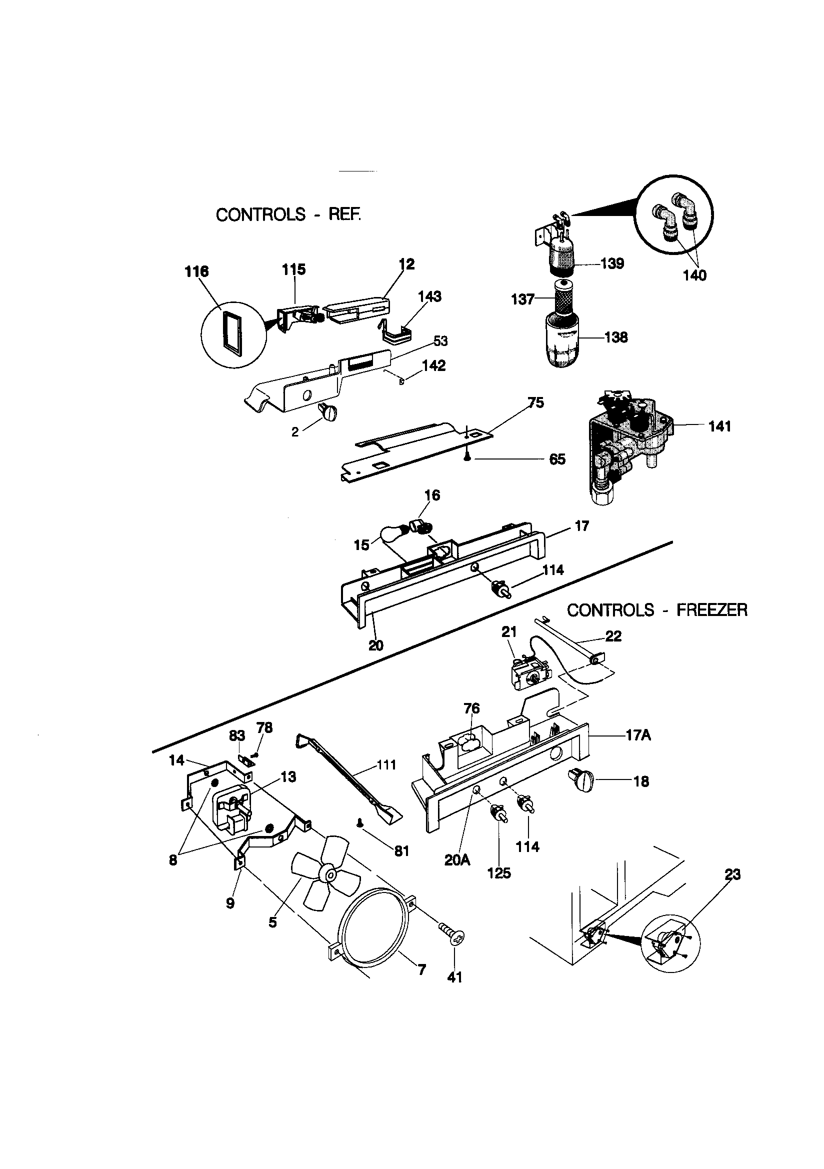

Looks like there is a faulty defrost system. Perform the troubleshooting as described in one of our previous thread: http://forum.appliancepartspros.com/refrigerator-freezer-repair/4221-freezer-fine-refrigerator-too-warm.html
The defrost timer is shown as #23 on the diagram. The defrost heater and the defrost thermostat are shown as #14 & #21 on the diagram.
Post the results.
