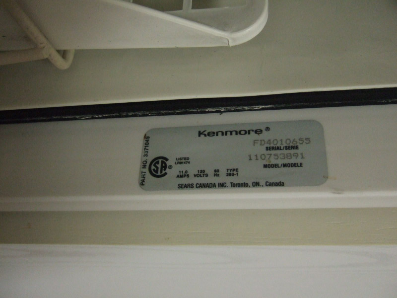

Sounds like the thermostat which you called “temp boost” is bad but to tell you exactly I would like to see the wiring diagram. Can you post it? Also the model number you posted is incorrect.
Hi Gene,
Thanks for the reply. The model number is right; it was purchased in '94 in Canada. See photo below.
The schematic was on the door; it’s kind of wrinkled. I’m not sure if that’s because of the glue running when things got hot.
Is it expected that the thermostat threshold to shift up like this if it is failing?
