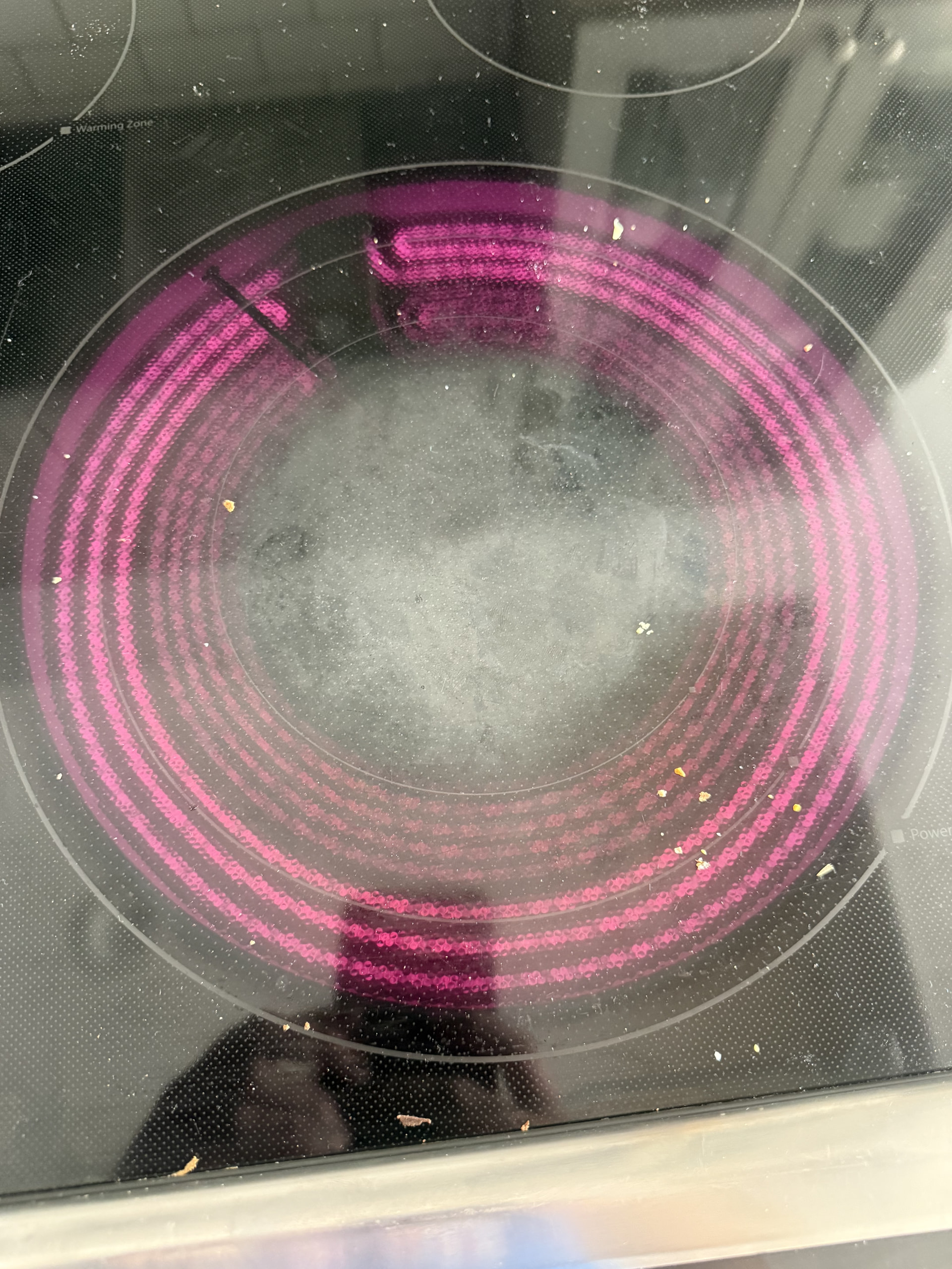

Brand: GE Model Number: PS920SF3SS Main Symptom: when at max setting the smallest element stopped working completely , the middle heats up but is very dim, the large most outer works as it should. What happens & when:
Parts or tests already tried: I replaced the element back in January (WB30T10155). Then when this issue started I bought and replaced the board (WB27T11356). When going through different settings I can hear the relays clicking but nothing happening at the smallest element. Is there anything else I am missing? Can it be a faulty element or something else?
Thanks for the detailed explanation and the photo! Looking at your GE PS920SF3SS, I can see the outer heating ring glowing brightly while the middle ring is considerably dimmer and the smallest inner ring doesn’t appear to be heating.

Hello, I did check the continuity of the inner hearing element and it was no open circuit. I also located the wiring going from the element to the board with no issues with connectors. Does the smaller daughter board (WB27T11355) is responsible to give power to that element?

Looking at the wiring schematics I was able to track down the correct wire that goes to the inner ring. The part number of the board is actually this (WB27T11357) it looks very similar to (WB27T11356) but its mounted in a different location. It is not the daughter board either. replaced the board and the element fired up as it should. Sadly they wont take back WB27T11356 board since that was the first thing I bought to to test out if it will fix the issue. Huge help was the pdf wiring schematics paper to pin point exactly what needed to be replaced.
