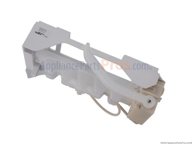

PRSC2222AF6 Ice maker quit working
Brand:Electrolux/ Frigidaire professional
Model Number:PRSC2222AF6
Main Symptom:ice maker quit working
What happens & when:tested the water valve solenoid, the water valve for the door showed 400 ohms, the ice maker solenoid showed 400 ohms, it seems the ice maker arm is stuck in the up position, what should I replace?
That sounds like the icemaker 243297613 itself will need to be replaced.
