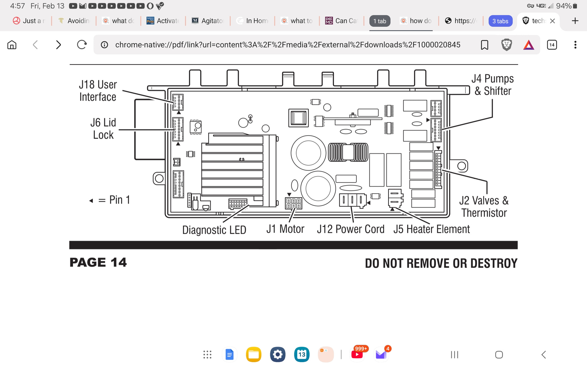

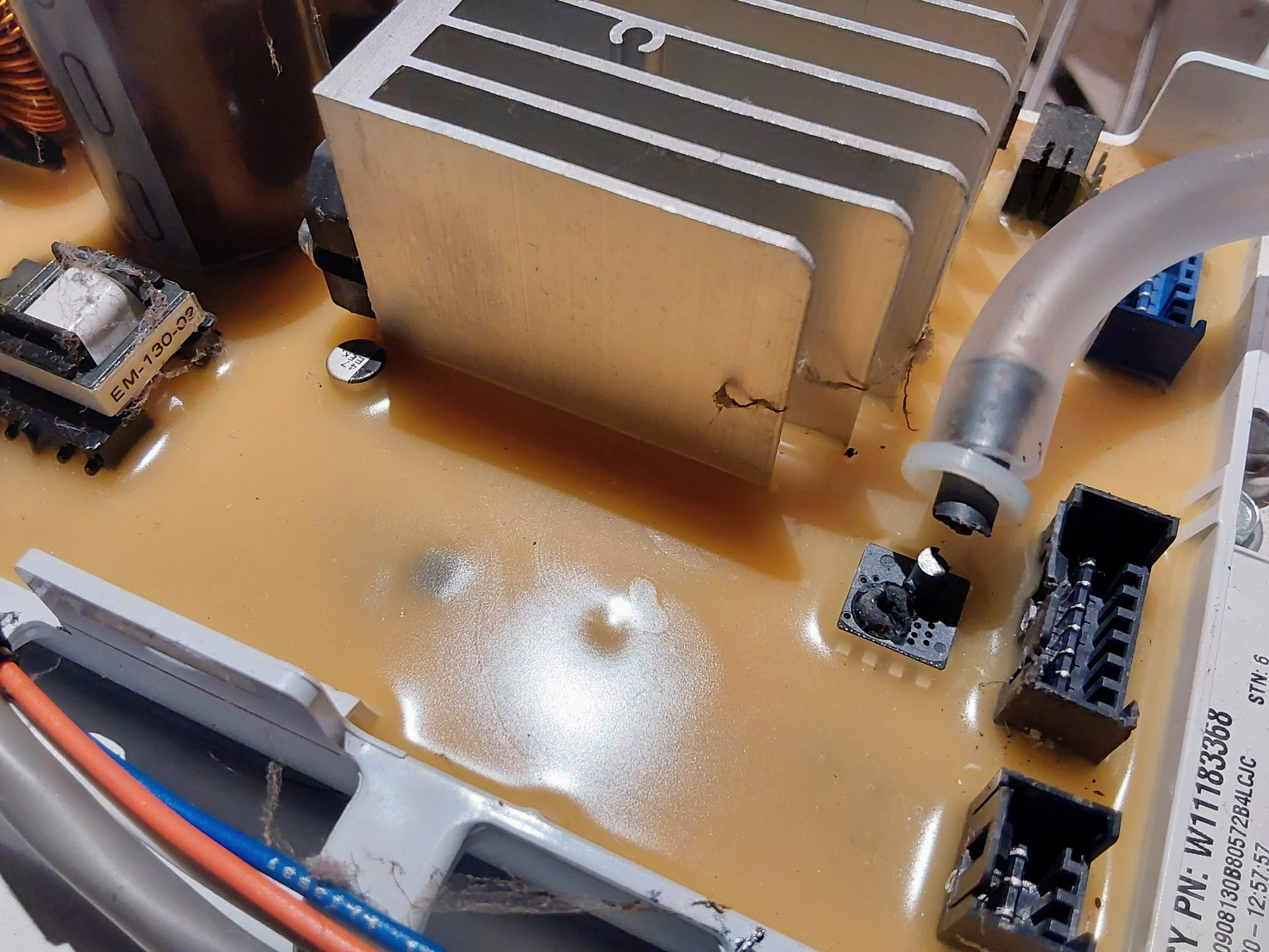

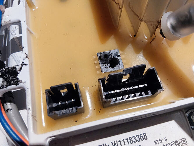

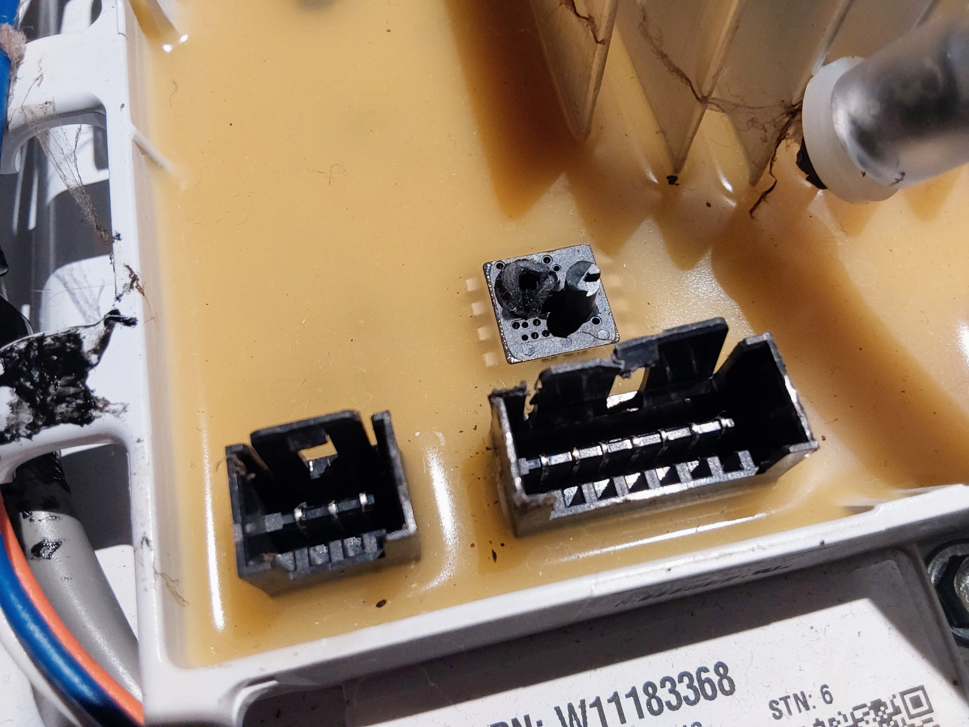

What happens & when: Washer lid locked wouldn’t open. Have new latch. Couldn’t pull old latch out, in locked mode. When prepping for new latch, post seemed to break to the right of J6. Can it be fixed (super glue?) or new part. If new part can you please foward directions. How do I get the old latch out please
Error Code (if any): F5
That is the pressure hose connection on the control board and with it breaking off you would need to replace the control board.
