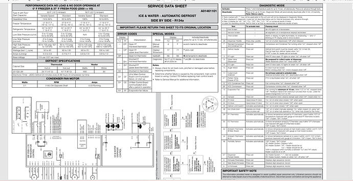

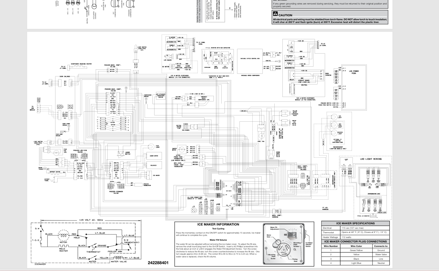

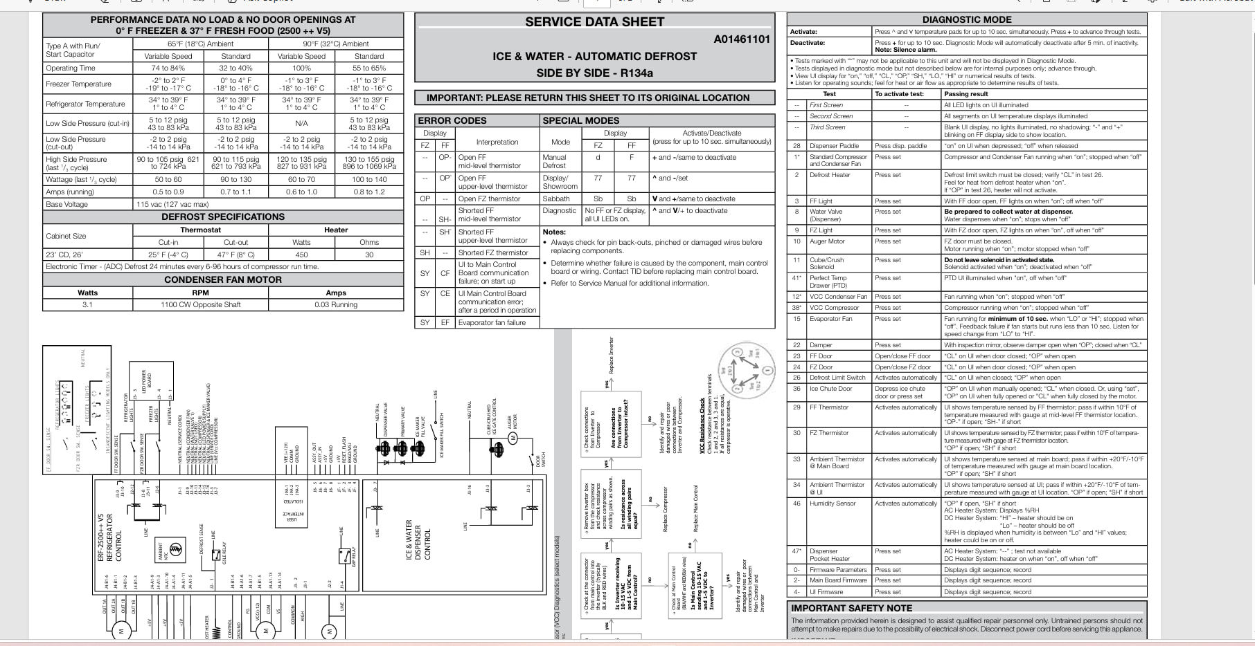

Hi mooseter90, I’m sending you a tech sheet. Use it to put the unit into diagnostic mode and see what codes come up. and let us see if we can help.
Appreciate the enclosed and will get to that this afternoon … I see how to engage and disengage the procedure in the upper RH corner of the 1st page. Do you anticipate this will work even if the the LED panel is not displaying? tks/Kevin
