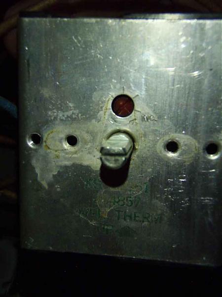

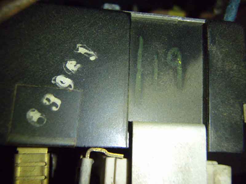

APP Team, some #s and pics.
Kenmore 103.9337020
These numbers from smudged first pic.
KS 63961
234857
Thanks for the photos. I wasn’t able to find a direct replacement from anyone, but I have a couple of options for you:
  1. Robertshaw 5320-175 might work but may need a pro to install. This is questionable and once you attempt to install the t-stat, you won’t be able to return it, so keep that in mind.
  2. Contact Repco. They may have your t-stat in stock and if not they may be able to rebuild your old one.
By the way, 234857 is the actual part number.
