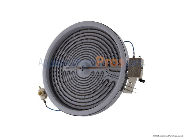

The part number is WHIW10823709

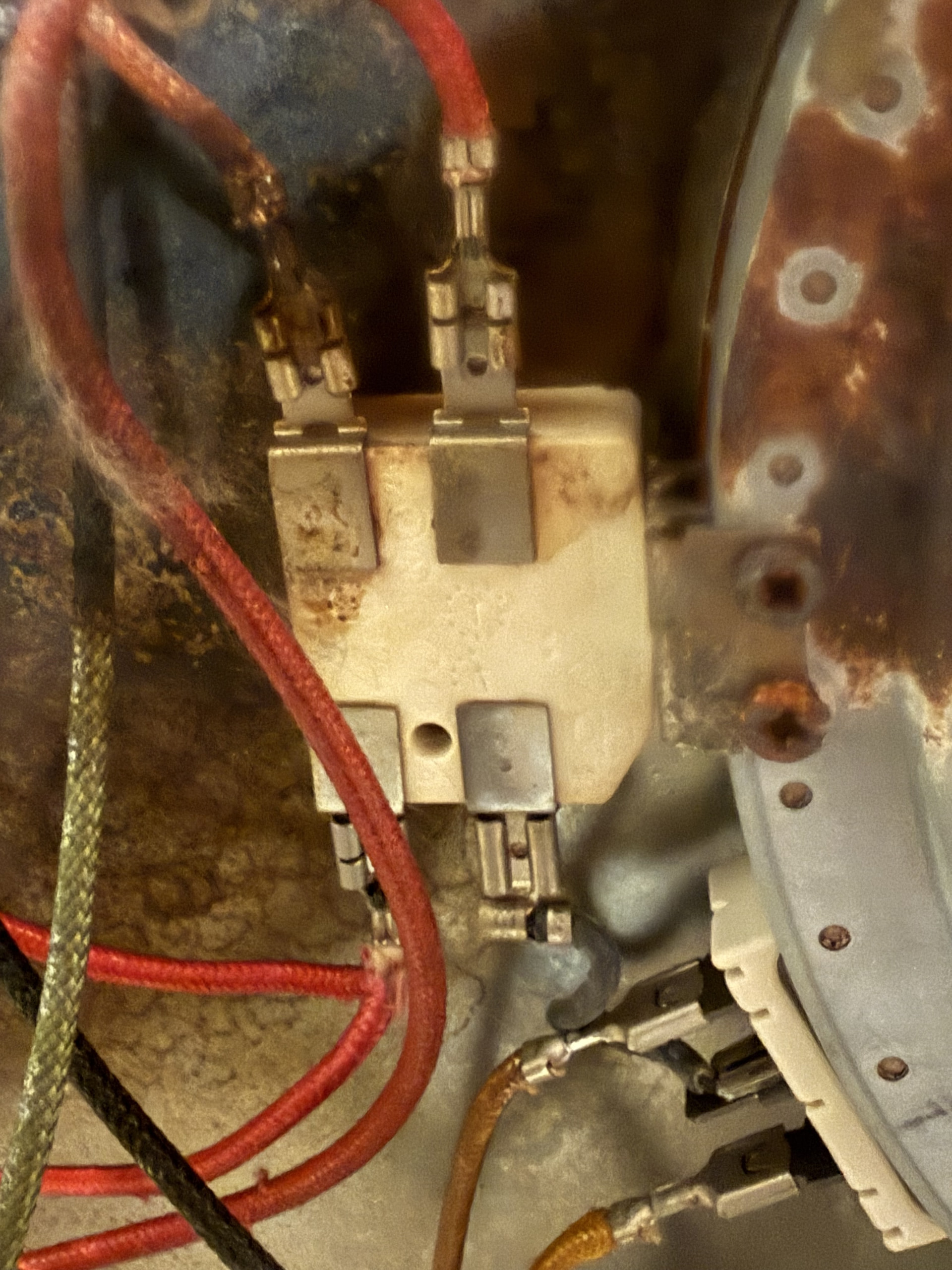

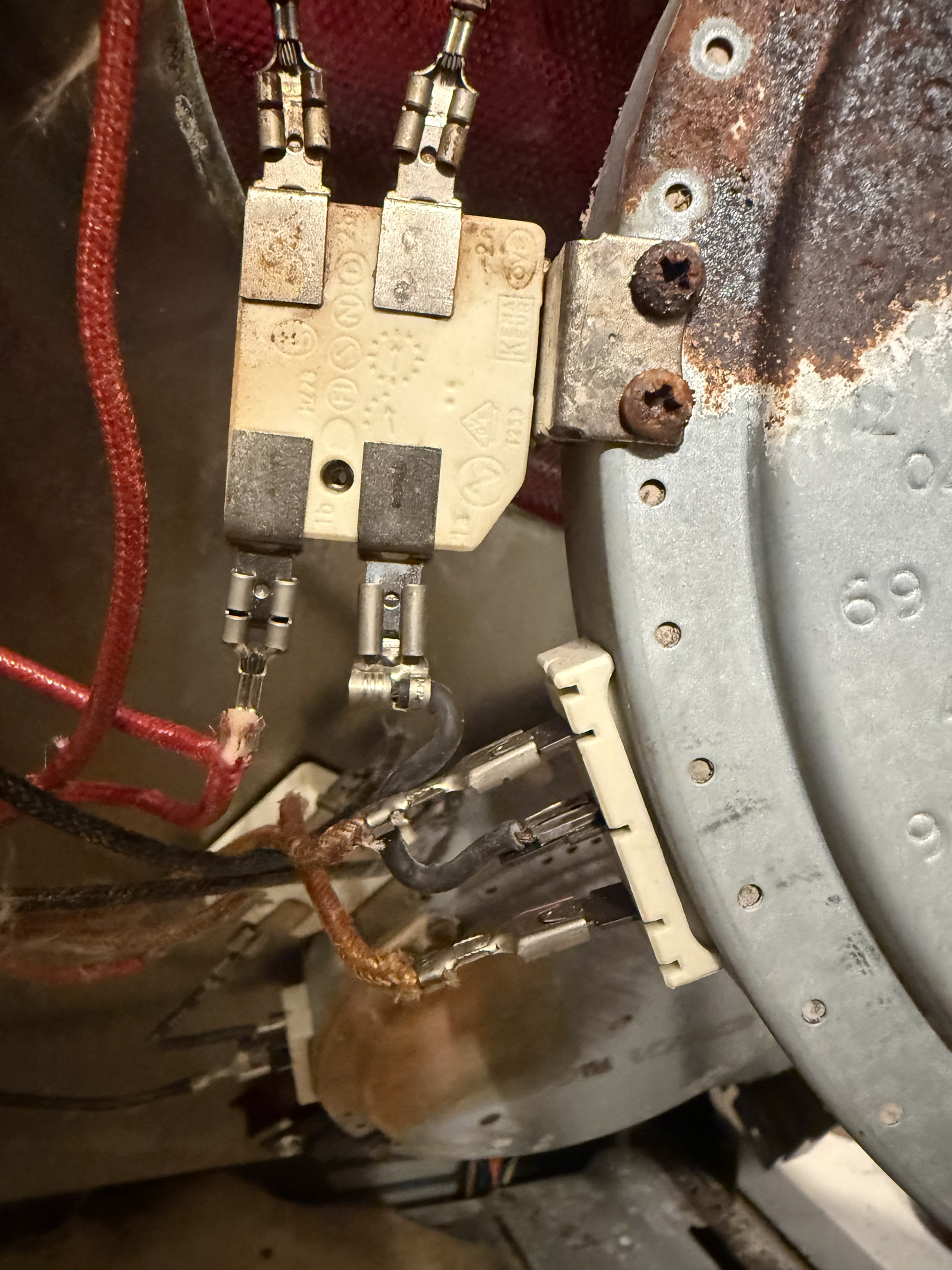

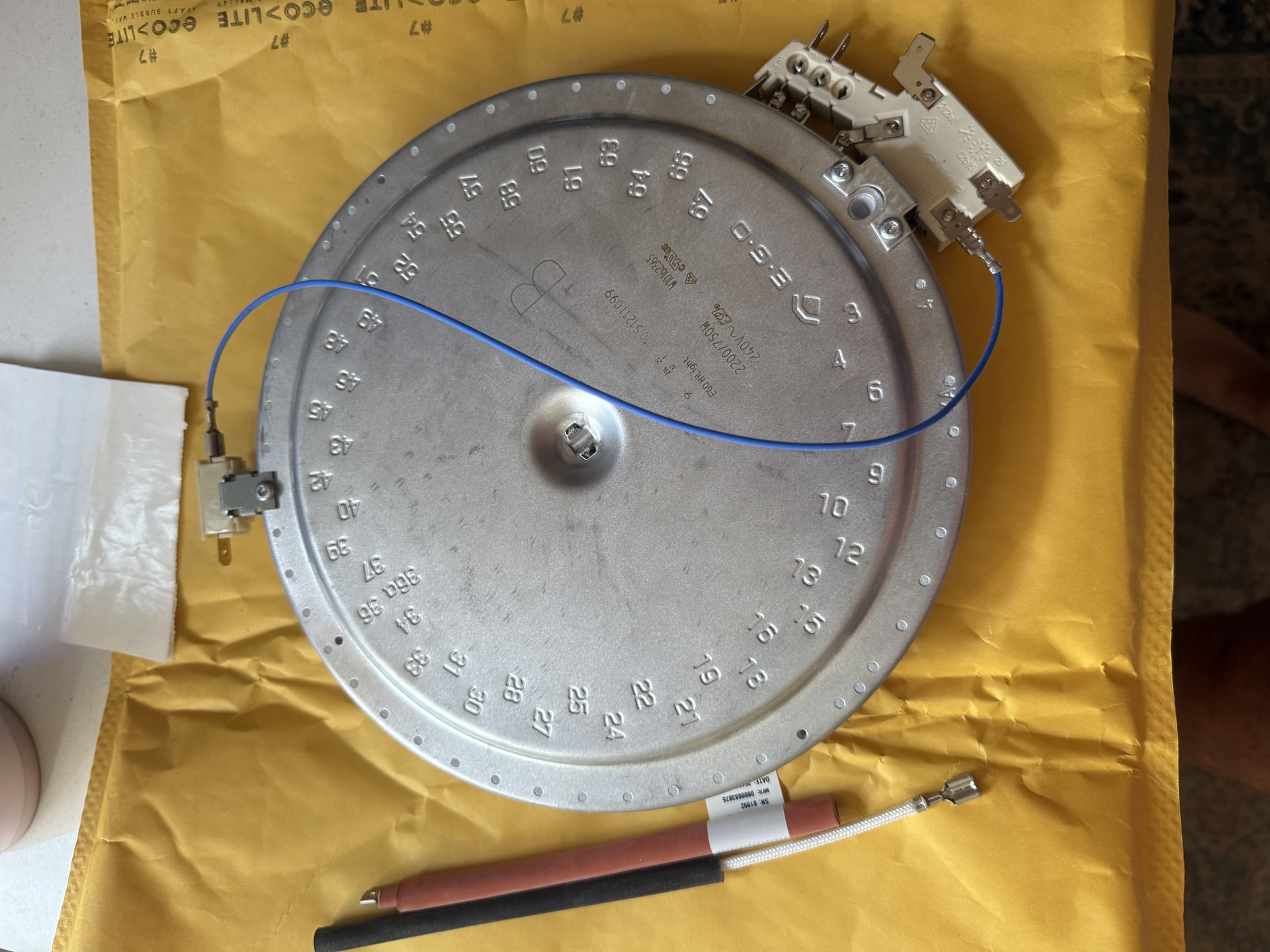

This is the original burner. The new has a different and not as many connections. Help please
Maytag MER6770ACC — W10823709 Installation
Important: W10823709 is the OEM replacement dual radiant element and replaces older numbers including 74004556. The replacement has a different terminal layout, so do not reconnect wires simply by matching their physical location on the old element.

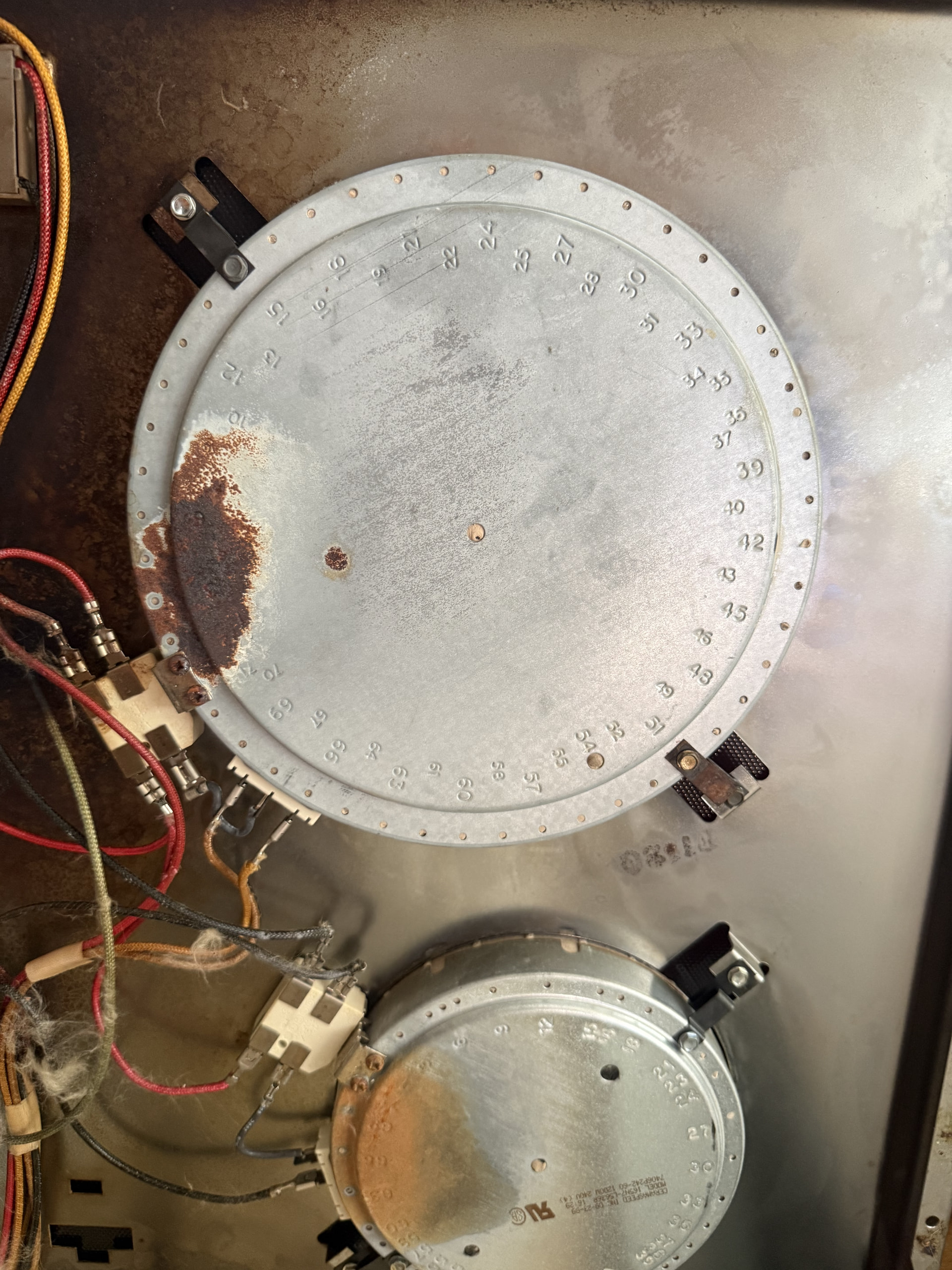

3. Photograph the OLD burner before disconnecting anything
  • Take one clear overall photo.
  • Take close-ups showing every wire and terminal.
  • Make sure the terminal markings/numbers on the old limiter are visible.
  • Label each range wire according to the old terminal designation, not merely “top,” “bottom,” “left,” or “right.”
This is especially important because owners installing W10823709 report that the replacement’s connections are located differently from the original.

  1. A clear photo of the old element showing all connected wires and terminal markings, and
  2. A clear photo of the W10823709 terminal block/limiter.
I can then map the old connections to the new element individually rather than having you guess at the changed terminal arrangement.
The doubled red wire to 1b single red wire to 2a tan wire to 2b. For the version with the attached indicator light:
  • Use the supplied wire extensions where needed.
  • The blue wire to the new attached light can be disconnected if the range’s original separate indicator light is still working.
  • If the original indicator light is not working, use the second extension to connect the tan wire to the open terminal on the new attached light
2 yellow wires to 3 and 4
