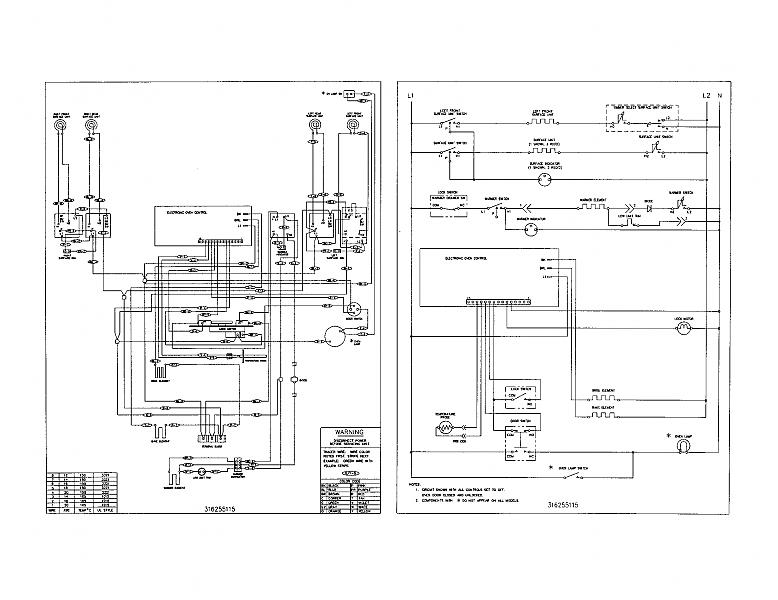

oven is turned off but still on,gives F1 on display,unplugged it for a few mins but still comes on.any thoughts on whats wrong.

See the attachment for the wiring diagram.

The manual covers a number of different unis so you have to be careful that the info actually applies to your unit. I believe your control board is an ES300.
Looks like F1 is a control board error.
I would also check that the sensor resistance is OK.
