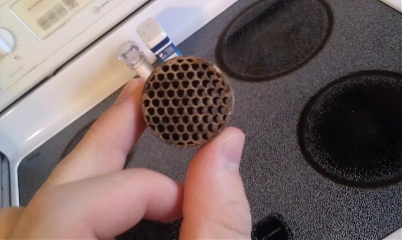

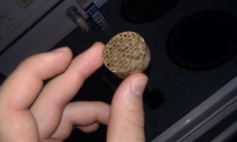

I have a whirlpool oven with a very similar issue, supposedly. I got this oven from a family member, who claimed when using it to broil, it would lock up, and turn itself into cleaning mode. The buttons would lock up and you would have to unplug the oven and plug it back in after 30 seconds to get it to reset and unlock. I currently have the oven set up, and am trying to force this error to occur so that I can record the error code to further diagnose it. I don’t ever broil anything, but I want to insure I have a safe oven. I have the manual and the tech sheet, so I believe it will be an F3 error. Also, I found some type of ceramic honeycomb filter looking thing in the oven, just laying there. I can’t seem to see where it would have come from except for a similarly sized hole that is just a tad too small. Any idea on that as well would be great.

Can you post a picture of this honeycomb?

Thanks for the quick response, yes, here are a couple images of the object. If you can tell, it does appear burnt, as if it has in fact been in the oven, while being used, whether it belonged there or not.

I have no clue what is it. The name plate with the model number should be on the oven door frame or behind the bottom drawer.
