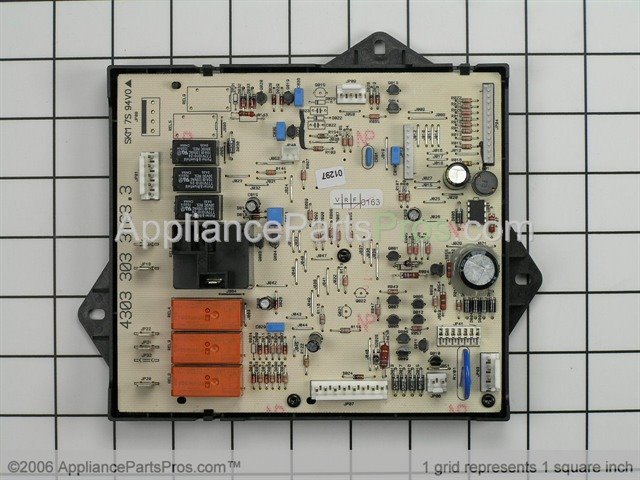

This is usually down to either a failed door latch assembly WP4451896 or the main control board WP4452444, both of these components have been discontinued by the manufacturer and are no longer available for purchase.

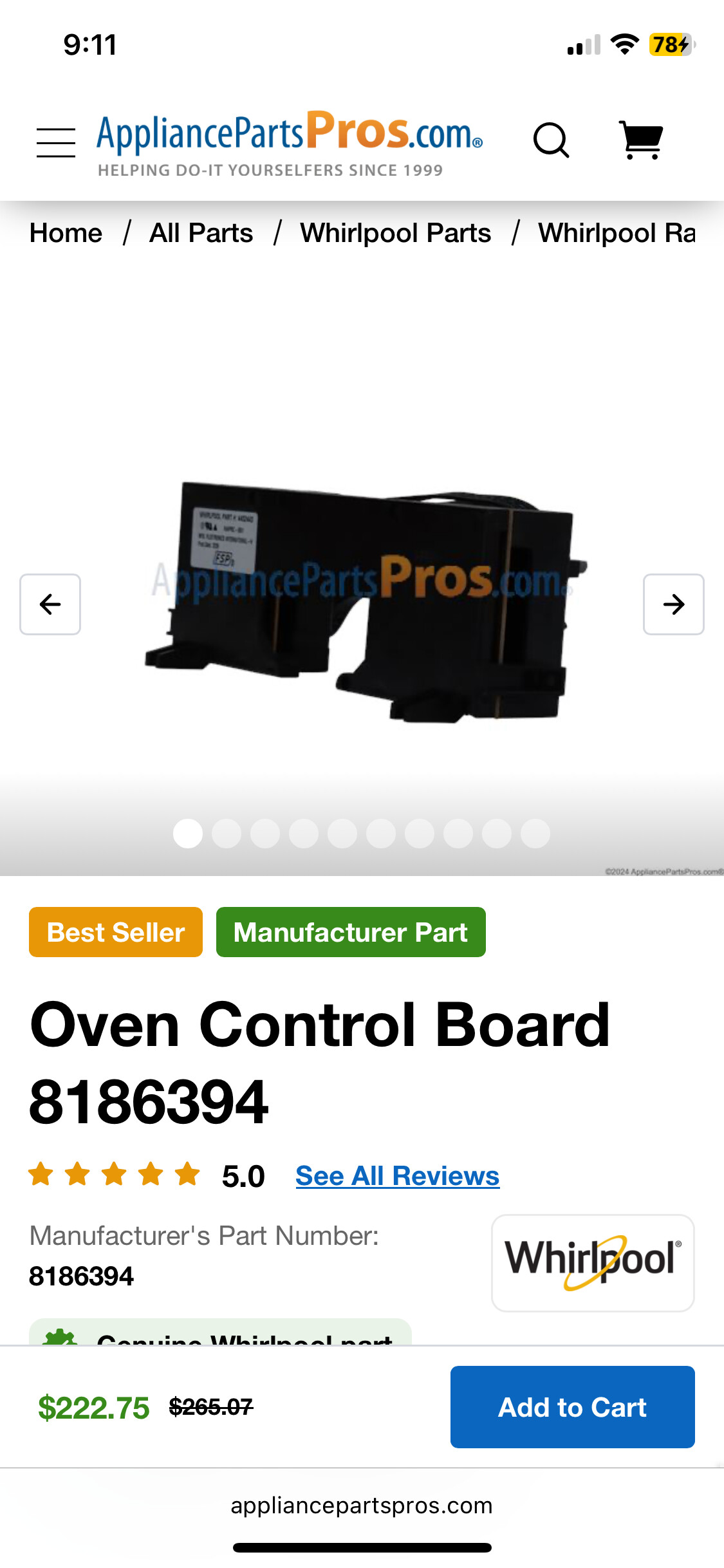

Thanks for the info. It wouldn’t be this type of control board? I can find these, but am not sure what the difference is between this and the control board part you listed (if it does happen to be that and not the latch assembly as you also mentioned).

The one you pictured appears to be the display part only on the consol.

Do you have any experience with repair services for this type of part? I’m wondering how reliable they are, and if that’s an okay option if replacement isn’t in our budget right now.
As long as parts are still available for the board or the board itself is not burnt or such they can be safely be repaired or rebuilt!
