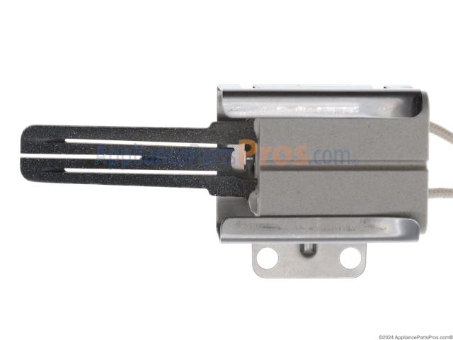

A gas range.
Does the oven bake igniter work/glow red?
Power to the ignitor when the oven is set but the igniter is not glowing = new igniter time.
If needed:
Yes the igniter can weaken and not glow hot enough…..still means a new igniter is needed.
