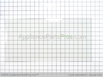

Sorry to bother you again, however, I want to make sure I order the right glass. It is the inner glass in the oven that is cracked.
I went onto the parts website that was provided and there are alot to choose from, inner, middle and front. So confused. Thanks

Bothering me is not a problem, much better than ordering the wrong part and being down longer than necessary.
The glass is Item 3 - AP2929117
The other part just holds it in place and is a mask.
