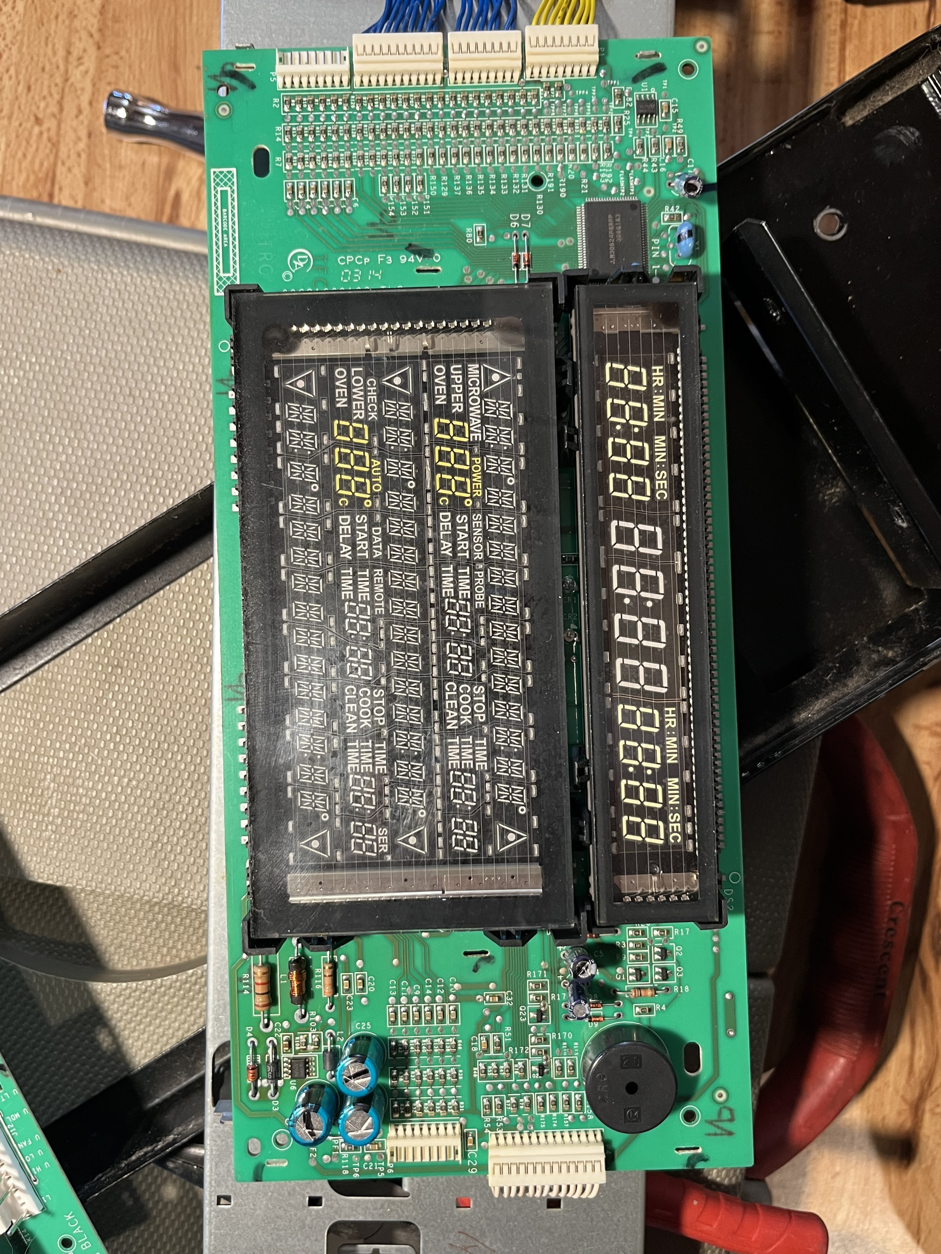

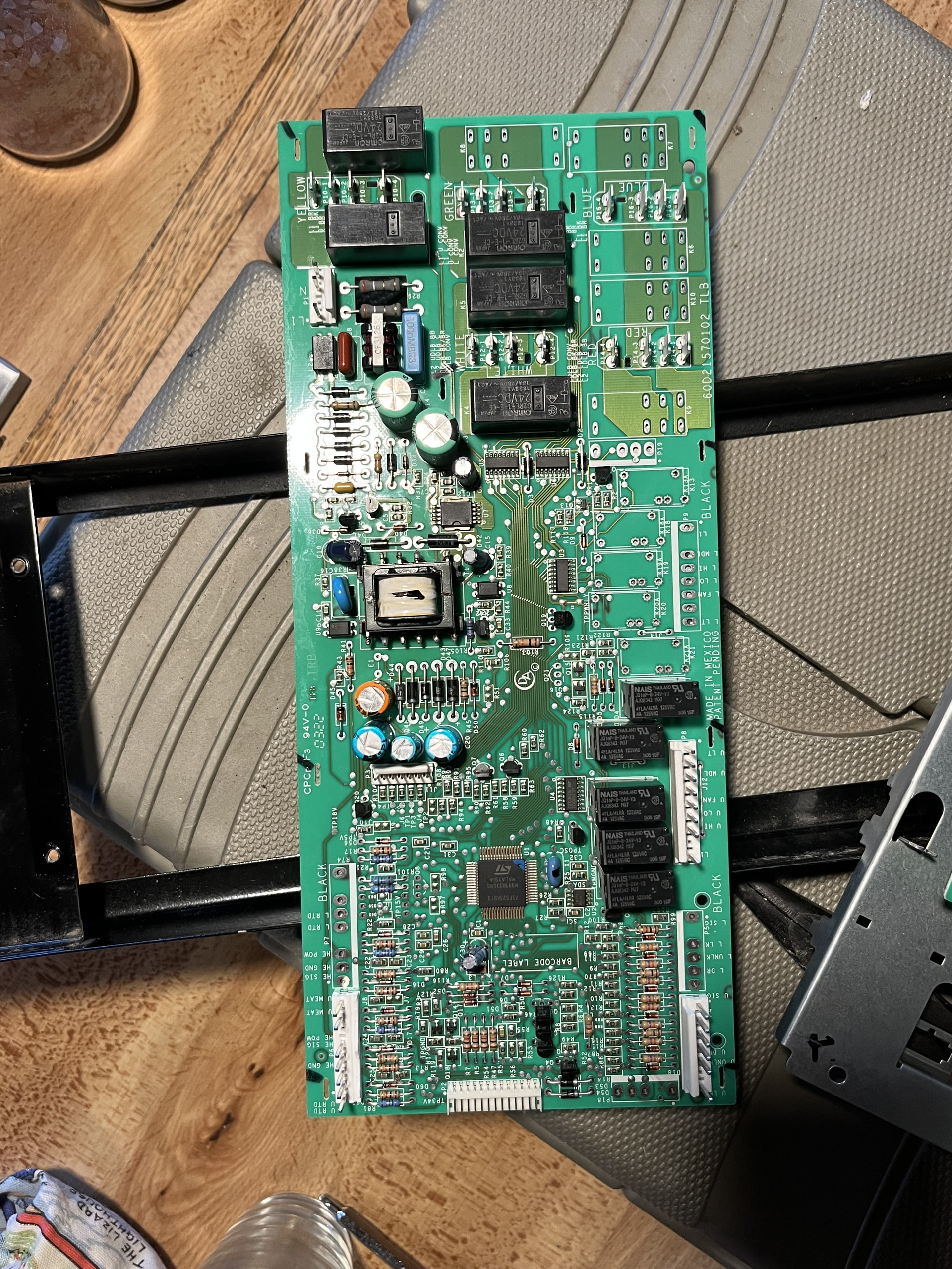

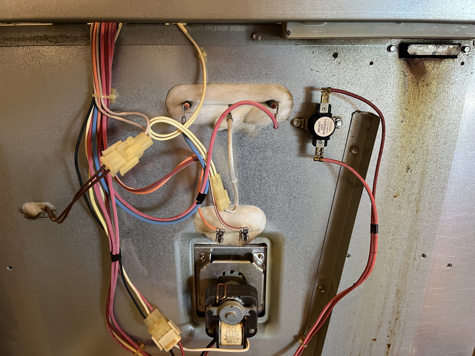

Well I was able to get the oven out of the wall, just 2 screws hold it in and were barely accessible. I took the back off and found what I assume is the thermal fuse, but I am not 100% sure. Can someone verify this is the part and if I check the continuity of it and its open then I need to replace this?
I replaced this part and still nothing at the front panel. I think the main control panel may be fried, and this is something like $270 cdn. :frowning:

The thermal cutoff (fuse) you show kills power to the emlements not the control board.
The fuse you want to find is item 7 in section 04.
It kills power to the control board.
The parts do not show a picture of it but it may be a bullet like device or just a lump in the wiring.
It is probably in the black wire going to P6 (control board)

After read your post i looked a little closer and found what appears to be a fuse of some sort (see photos) and the info off it is: Microtemp, SZBAZF, G4A01, TF077C. I pulled the connectors off each end and rang it and its open?
Could this be the fuse that I need to replace? It does lead right to the circuit board to a plug with ‘L1’ for the black.
Yes that is a thermal fuse.
I ordered a replacement for this, so I hope this does it! I was thinking it might be the main board.
Well I have success and have my oven working again. I guess wall ovens weren’t made to take the heat that is produced during a self clean. I blew 2 thermal fuses during my first self clean! If I had hired a repair man god only knows what I would have had to pay!

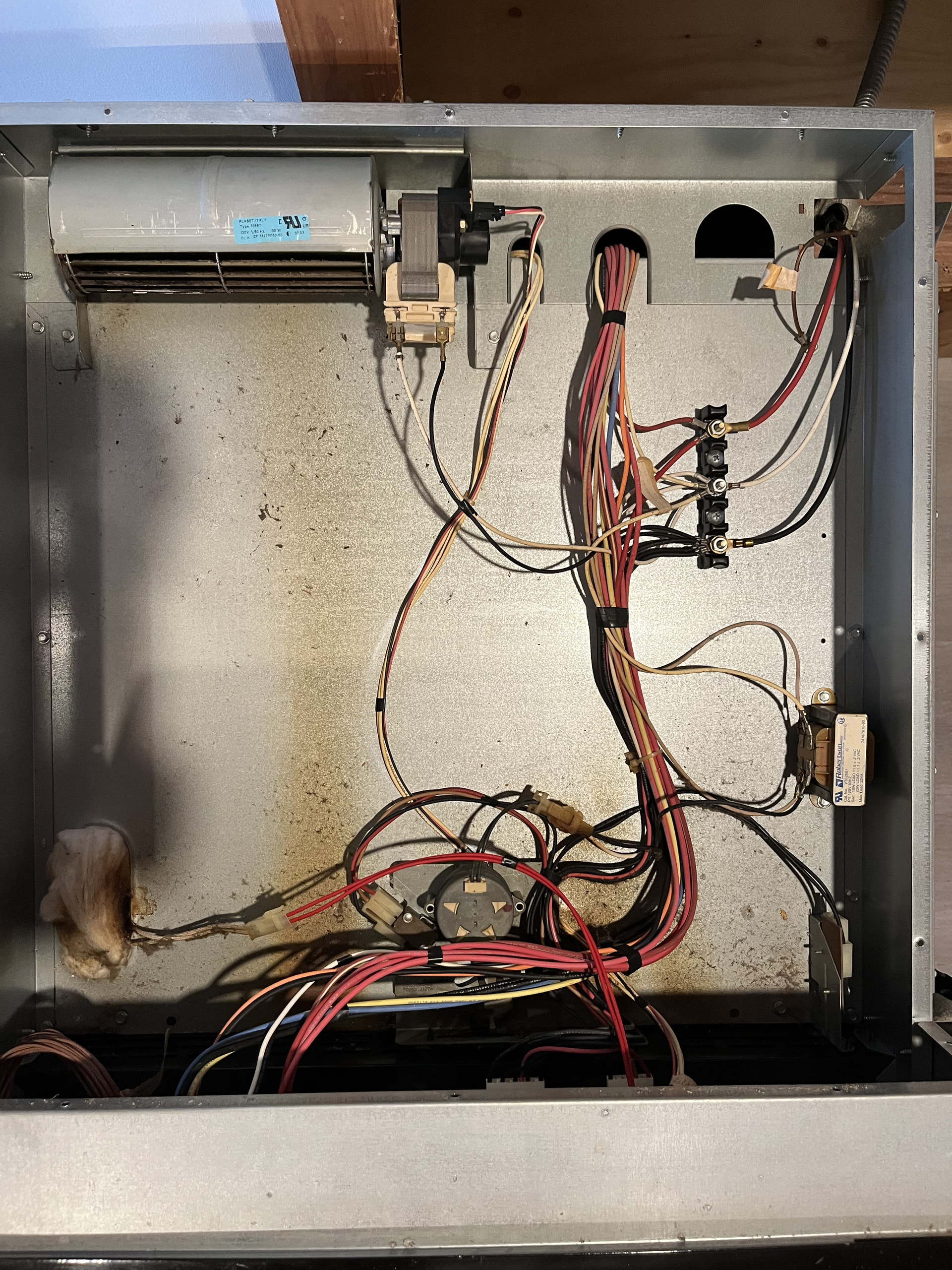

Hi there, I have similar issue now. I was reading your post. However, the pictures are no longer available. I’ve found the first thermal fuse at the back
of the oven. It’s working properly. However, I cannot find any other thermal fuse. Could you please share your picture again? I’ve attached my pictures as well
