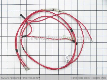

Locate and check for continuity the 20 amps inline fuse which is a part of the main wire harness (look at the picture).
