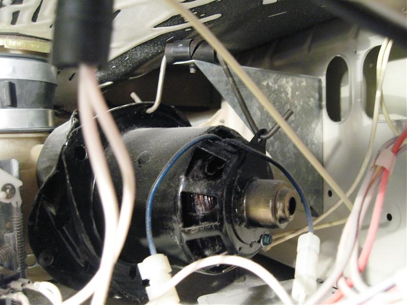

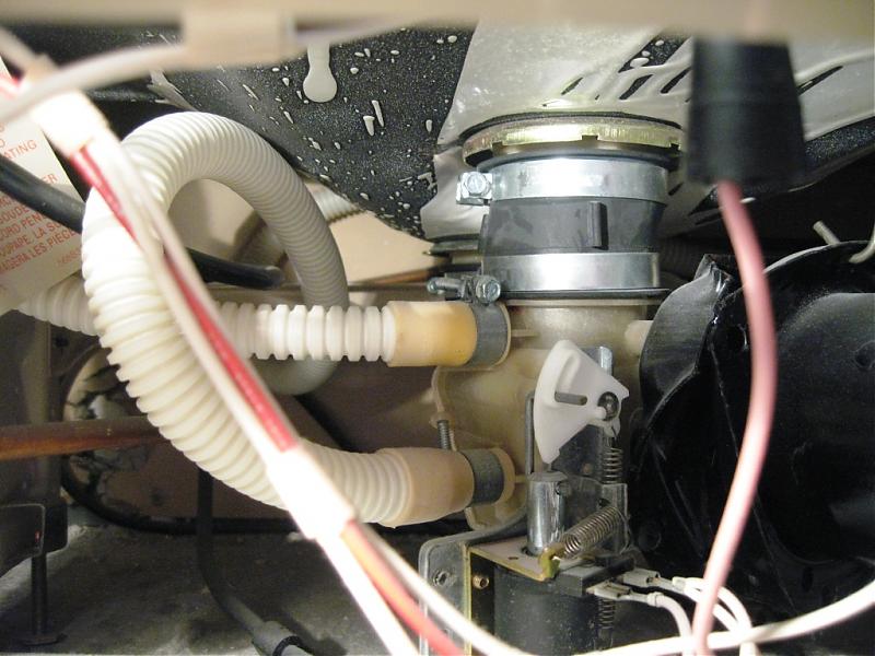

Hi Joe,
Thanks a lot for responding so quickly!:slight_smile:
I opened the bottom panel and tried looking in for the blade but couldn’t spot it. i made use of a lamp too..may be i will try again in the morning in daylight. I have attached two photos that i took so that i could get some additional help. Please let me know approximately whereabout i would find the fan blade.
Many thanks.
Best wishes,
Jeffers
Jeff Dishwasher 1.jpg (69.2 KB)
Jeff Dishwasher 2.jpg (64.8 KB)

Jeffers,
Thanks for the pictures,
I’m using picture no.2
If you slowly and carefully slide your hand down the motor housing(the black part), all the way to the end, towards the (white plastic) pump housing, you will eventually feel a gap, approximately 3/4 inch between the pump housing and the motor housing.
If you slip your finger into the gap, you should feel a plastic disc with vanes molded into it, you should be able to grip one of the vanes and turn the motor shaft a couple of revolutions and break the motor shaft loose.
I am including a picture of an “open faced” motor, so you may have a better idea of what to expect( it will not look like your motor but the concept is the same).
