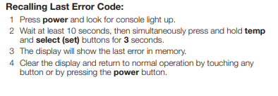

Is there an error that appears with the new control using the recall error mode (as seen in the image)? Also, have the thermistors been tested for resistance? The blower outlet thermistor should measure 5K Ohms and the back panel inlet thermistor should measure 50K Ohms.
thank you, I didn’t think to check for errors since the board was new. now I am observing errors 35 and 41. I am nolonger being E61. I think I have a defective board.
Since this is a new symptom, I would suggest double checking the wires and making sure nothing is loose. The error 35 is a communication problem between the UI control and the main control. If the wires check good, it is possible the main control is faulty.
