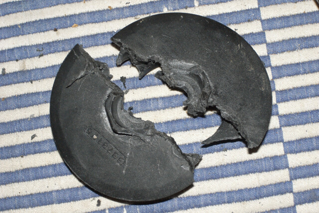

Well, I broke the impeller in pieces, and in doing so, broke the lower bit of the impeller, too. I found a cherry pit, a piece of straw and a plastic clip in the pump. Could that make a “grinding” noise in your opinion? Not sure what to do next. Is it worth trying to reassemble this with new impeller parts? Or should I just suck it up and get a new pump and motor assembly? Appreciate any advice. S
[QUOTE=Gene;189311]Actually you have nothing to loose. Take the pump apart and check what makes that noise. Post the results.
P.S. You can break the impeller in pieces. If you’ll end up rebuilding the old pump, then both impellers are included in the new impeller & seal kit.[/QUOTE]
