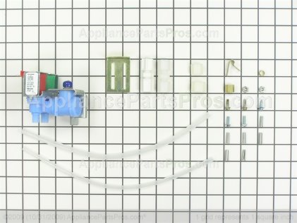

The first thing I would do is: switch around plugs on the water inlet valve and push the water lever on the door water dispenser for a couple seconds. If water will come into the ice maker then the problem is a bad solenoid on the water valve for the ice maker. Replace it.
[CENTER]Water inlet valve[/CENTER]
[CENTER][COLOR=#800080][/COLOR][/CENTER]
If water would not come then the problem is a frozen water feeding tube for the ice maker inside the freezer. Remove the ice maker and defrost the tube using a hair dryer. The water inlet valve in that case still has to be replaced because it does not shut off completely.
The part number for the new water inlet valve [COLOR=#800080]AP3103466[/COLOR]

Thanks! That was the problem. I knew if I kept asking questions I would find the correct solution to fix my ice maker problem. I appreciate your assistance & knowledge.

Mine now works! There are two water valves in the Refrigerator. (located in the back, about 3 inches above the floor. One on each side.) Both needed to be replaced. Once I did that, the water ran freely at the door. It wasn’t the filter at all. I did sand the contacts on the existing water valve and my ice maker started making ice again, so apparently the water feed side of the water valve was not working. (you might give that a try before purchasing a replacement valve.) There is a yellow and a green electromagnet that operates each valve. On the second valve, green feeds the icemaker and yellow feeds the water.
