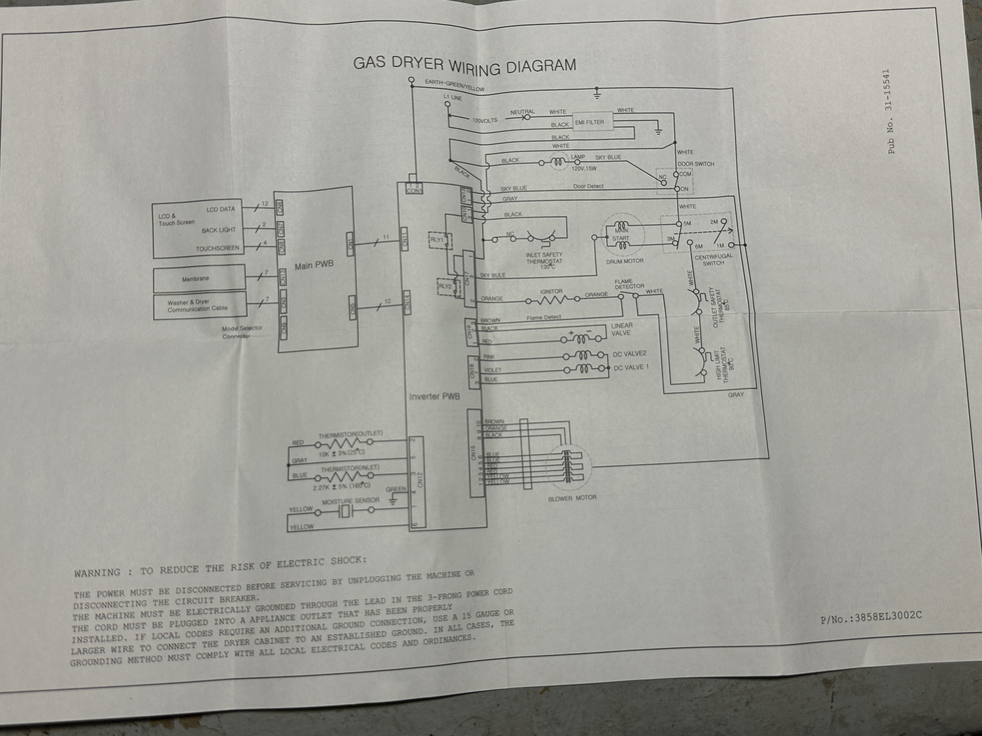

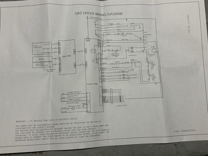

No power to display
Brand: GE
**Model Number:**dpgt750gc2ww
Main Symptom: None of the control buttons response. No display showing
What happens & when: First it made an unusual noise. Then the power went dead. Took apart. I found a broken belt and frozen roller when I took it apart, but don’t think that would cause this problem. Fuse on control board is OK. Looks like it might be the INLET SAFETY THERMOSTAT -130ºC on the diagram but I am not sure which part number that is.

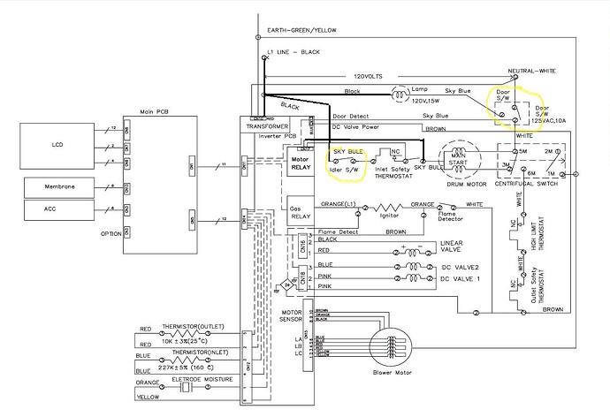

Check for the power into the control board, check the door switch, the idler/belt switch.
Thank you. Of course the idler circuit is open with a broken belt. Does that cut power to the display and circuit board? Does not look like it from your diagram, but it looks like it does on mine. Door switch is OK.
GE-Harmony-Dryer-31-9104.pdf (2.7 MB)
31-15541 GE DPGT750GC2WW Harmony Dryer.pdf (94.7 KB)
It was the idler belt switch. When that switch is off, there it cuts all power. Works find now with a new belt.
