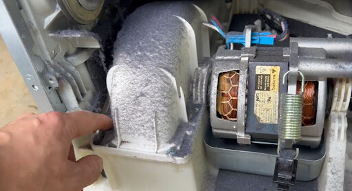

No idler pully for motor
Brand: LG
Model Number: dlec888w
Main Symptom: Motor loose
What happens & when:Motor body rotates
My first post. I replaced the motor but don’t see an idler pulley or tensioner to keep belt tight. Motor body rotates on it’s mount, assumably to change belt but no tensioner!
Hi Shingabiss,
On this model, the part you’re looking for is located on the motor. I’ve provided a picture to help you identify its location.
Mine doesn’t have an idler pulley, just a spring. See later response, but thank you!
that spring is what gives tension to the belt
Thanks. Do you know the PN of the clip?
The pn for the Coil Spring is 4970EL3003E
