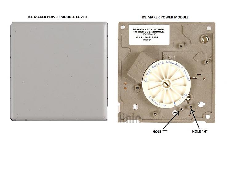

It’s probably the ice maker that’s causing the issue. Try to force cycle the ice maker. If it doesn’t start a harvest cycle, replace the entire ice maker, part# W10122559
To force cycle the ice-maker, remove the cover over the ice maker module and locate holes “T” and “H”. Take a small piece of wire bent in the shape of a U and short “T” and “H” together. The ice-maker will start the harvest cycle. Wait about 10 seconds and remove wire. The Ice maker will continue through the cycle.
This might help:
Ice Maker Module.jpg (33.1 KB)
