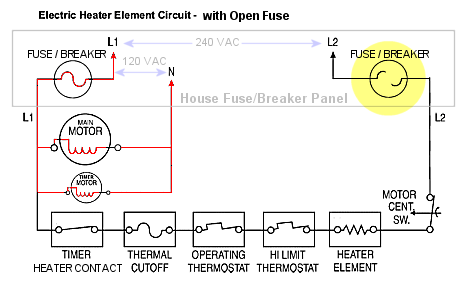

I have the Kenmore Elite H3 Limited Edition Dryer. The dryer has power but no heat.
Could the reason be something as simple as a fuse?
Where is(are) the fuse(s) located so I could have a look and how do you test and replace?
Please help -

There are many things that can cause a no heat symptom in an electric dryer, here is a list of possible causes in order of likelihood or ease of access.
An open fuse/breaker in the house fuse panel.
There are 2 fuses or breakers for the dryer, both must be good in order for the dryer to function properly. If one is open, it is possible for the dryer to run but not generate heat. In the case of breakers, try resetting them as sometimes one of the two can open but not physically tip the mechanical lever.
The illustration above shows how the main dryer motor and the timer’s motor can continue to operate with one of the two fuses for the dryer open as they operate on 120 volts only. The working circuit could also include a light which is not illustrated.
