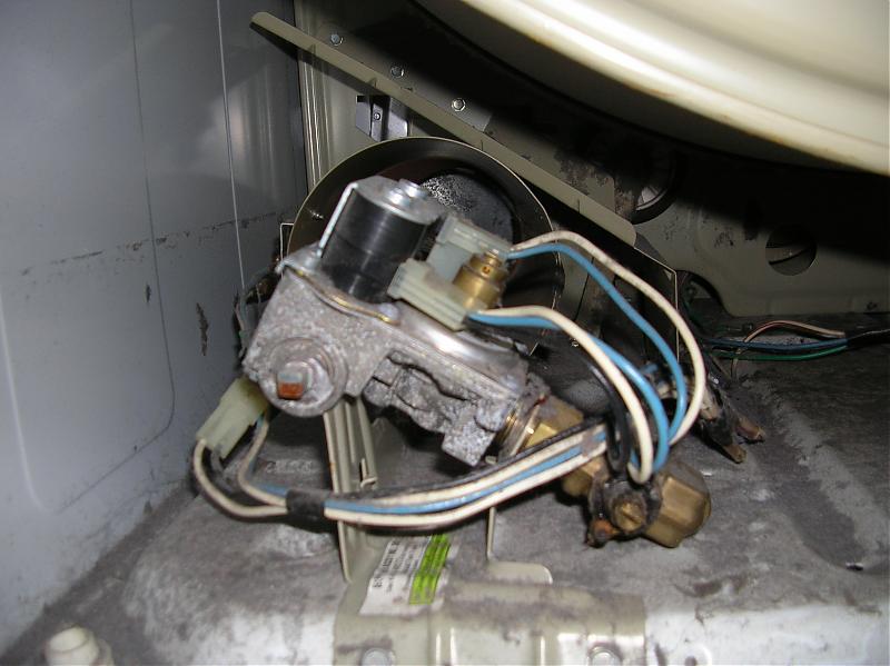

I’ve checked the themal fuse today, looks like it has continuity.
But I don’t know how to check the t[FONT=Arial][SIZE=2][FONT=Arial][SIZE=2]hermostat [/SIZE][/FONT][/SIZE][/FONT]continuity.
I checked the continuity between two red spots, they have continuity, but nothing between two purple ones.
How to check continuity on t[FONT=Arial][SIZE=2][FONT=Arial][SIZE=2]hermostat [/SIZE][/FONT][/SIZE][/FONT]?
Looks like the cycling thermostat is fine. Now you have to check the igniter, flame sensor and gas valve coils.
You picked up the wrong thread on the forum from the beginning. This thread describing troubleshooting for electric dryers. You can find the troubleshooting for gas dryers here: http://forum.appliancepartspros.com/dryer-repair/4743-no-heat-gas-dryer.html

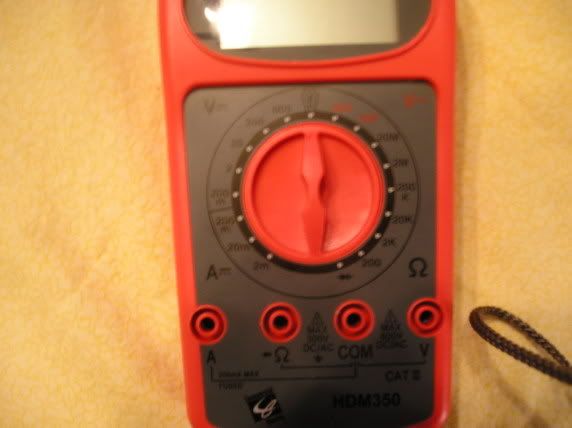

I have 120 on each side(I am assuming that would comine itself to 240) How would I check both sides combined? Use gator clips to both hots? I barely mess with 110vac and almost never 220vac (but I don’t hesitate to jump on 12vdc!)
How did you measure 120 VAC? What kind of meter did you use?
One of these (not my pic)
http://media.photobucket.com/image/commercial%20electric%20hdm350/Herec/PA230009.jpg
Commercial Electric HDM350 DMM
