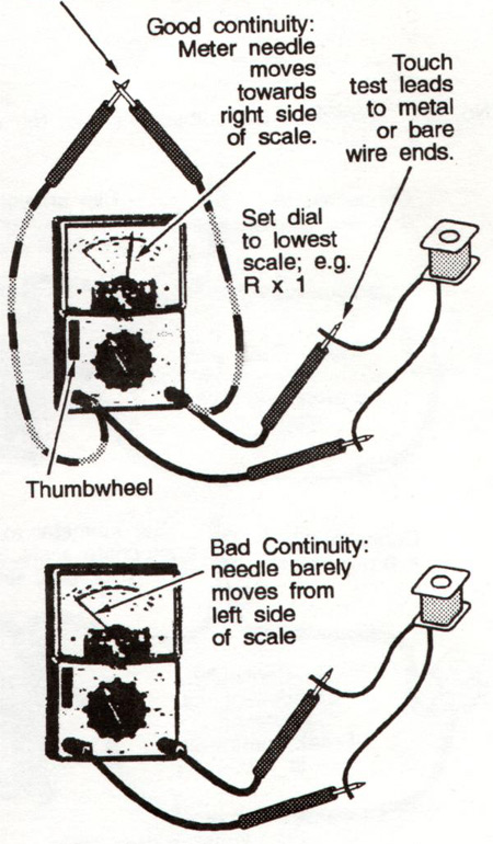

Resistance ( or continuity ) is measured in units called “ohms.” You’ll commonly want to know the resistance of things like bake elements and solenoid coils. For example, a good bake element typically has a resistance of about 30 ohms. If your oven’s not baking and you measure the resistance of the bake element and the meter doesn’t move, then you know you have a bad element. Everyone is looking to save money, from coupons to tax deductions, so finding out if a repair is possible before you buy a whole new unit can be a great way to save. A simple ohm measurement can save a lot of money :slight_smile:

Both elements show 0L on the meter and have no continuity, which would make sense. I was just wondering if I could be missing something since it is in my mind unusual for both elements to be bad at exactly the same time. Could a faulty control board possibly have caused this condition?
What other scales are on the meter?
The reading changes when you touch the meter leads together?
