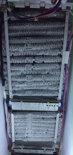

  4. thinking my evap coils were frozen I removed the back of the freezer panel. See pic for how they currently look. Do they look normal for 4hours of on time after a manual defrost?

From what you wrote about the fridge, I dont think anything is wrong with it. You mention the temps are -2 and 33? Those are pretty good temps, you probably have the temp in the fresh food turned to the coldest setting. The pic of the evap looks normal. Your heaters work, the fans are running. It is summer time, and without a food load in there, you are short cycling. Meaning as soon as the compressor kicks off, the temps rise quickly causing the fridge to seem like it is running constantly…Put jugs of water in the freezer and fresh food section. Get your thermometer you bought and after 24 hours check the temp of the water in the fresh food. Bet it’s normal…Good luck
Just wanted to update the thread as many times people never do when the problem is resolved. Seems like abadfish66 was absolutely right, after about 36hours the refrigerator is cycling like it supposed to. I purchased a new thermostat and defrost timer that I’ll keep just in case but the temps are steady and everything seems to be working correctly.
It stills runs a bit longer than my 1yr old fridge in the kitchen, but I’ll chalk that up to this one being older and less energy effficient.
