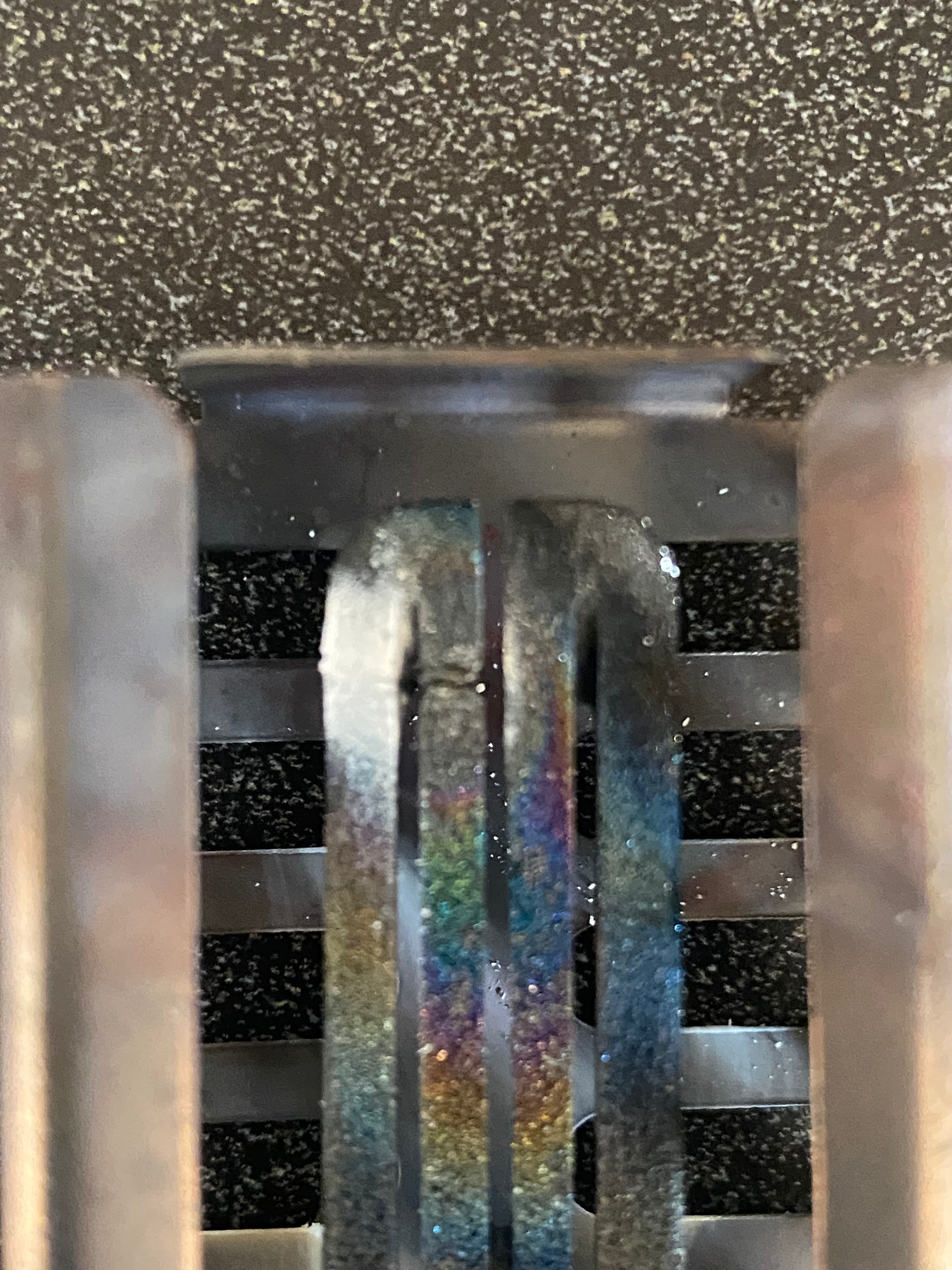

Brand: Jenn air
Model Number:JGS9900BDS
Main Symptom:not preheating for baking
What happens & when:I replaced the ignighter with a new one and it worked once now the ignighter isn’t showing any ohms I tested the amps going to it and it read zero
Parts or tests already tried:tested for amps without ignighter hooked up. No amps.
Is the igniter glowing at all? If it is not, then it is probably not getting voltage from the board. If it glows and does not open the gas valve, even after replacing the igniter, it is probably the gas valve.
It worked once then the ignighter burned out. It has a crack through the element. They are sending me a replacement but I didn’t know if it was a result of too much power from the board or just a bad ignighter
They are just real fragile, a new one should take care of it. As long as you didn’t get it from Amazon, they are probably made in China and will not last. LOL
No got it from appliance part pros. I’ll try the new one when it gets here. Thanks
