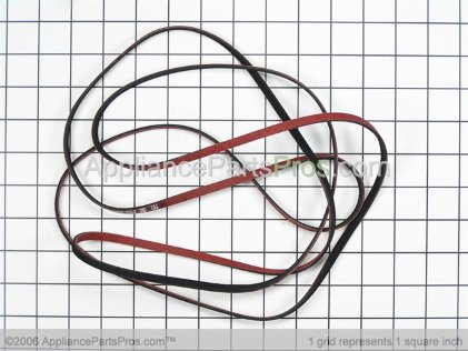

The other thing which can cause it is a belt longer than it suppose to be . According to the part description (AP2946843) it should be 92-1/4".
