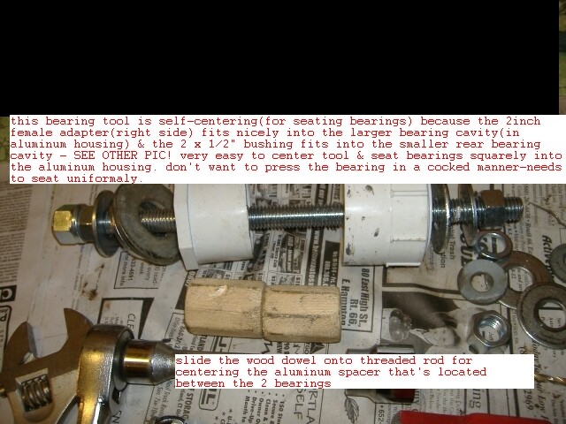

Just completed my neptune bearing repair. The job was made easier by info found here & other forums. Thought I’d give back by posting a picture tutorial of my experience & maybe someone facing the same repair will find this helpful. There are 14 pics with comments, maytag manual, maytag technical bulletin & 1 text file. Highlights include home made, cheap bearing seating tool, close-up pics & severely corroded aluminum housing that was salvaged using JB Weld.

however, it’s NOT a required, must have tool. there are other methods available that will go a long way in keeping expenses to a minimum - other than the cost of parts. the bearing seating tool in my first post can be assembled for approx $10 & a cheap bearing puller can be had for $25 or less. a puller is optionable but without it you’ll need to commit more time & patience to bearing removal. i prefer using a 3-5lb mini sledge & heavy pipe or drift. make contact with the outer ring/race of the bearing. careful not to gouge the relatively soft aluminum housing. don’t use a short piece of pipe that will guarantee you hitting/cracking the outer tub should you have a mis-directed swing of the sledge.
other than my time, price of seal kit & bearings, my additional cost for seating tool, jb weld & rotary wire brush…about $20…making the entire repair less than $80.
in the world of bearings i’d rate this a ‘2’ on a scale of 1 to 10, and that’s only because of the spacer that resides between the two bearings - needs to be centered so the spindle shaft can be inserted. of course, if you’ve never laid eyes on a bearing and/or never been inside a major appliance then i understand rating this a 10 on the difficulty scale.
…and that’s where the cost of the tony tool is completely justified and represents a good value.

Thank you so much for your work. I am in the middle of a bearing replacement and this thread is quite helpful. I have a couple questions for you:
The pvc adapters you used for the bearing tool, I know you said they are 2" fem adap w/cap and a 2x1/2" bushing,… did you have to modify the pvc fittings? I imagine you had to at least drill a hole in the cap. Thanks again for your work!

Barnaby: yes, i did modify the cap(more like the threaded plug) that screws into the female adapter, simply drilling a hole in the center for the threaded rod to pass through. The bushing was left as is when bought with the 1/2" hole more than big enough(slightly oversized) for the threaded rod.

[COLOR=#000000]I have the bearings and seal on order. I am collecting the parts to make the tool you describe. Most of the stuff is right off the shelf at the big box store. I hope to have everything ready when the parts arrive.[/COLOR]
[COLOR=#000000]I just need the wooden dowel. You did not provide dimensions. I would like the O.D. and length so I can make one A.S.A.P.[/COLOR]

[FONT=Calibri][SIZE=3][COLOR=#000000]I bought the bearings and seal through Amazon.com. The bearings came from Reid Supply ($5.82 & $8. 22) and the Seal from McCombs Supply ($31.95). While I was waiting for the bearings to arrive, I gathered all the parts to make Crystal368’s bearing tool. I could not make a good wood dowel. I don’t have a lath. I couldn’t do a good job of drilling the hole in the center with a drill press.[/COLOR][/SIZE][/FONT]
[FONT=Calibri][SIZE=3][COLOR=#000000]The hardest part of this job is the bearings, particularly the front (inner) bearing (getting the bearing in and out). Thursday night I got the machine apart and the rear (outer) bearing out. I sprayed penetrating oil on the front bearing and called it a night. [/COLOR][/SIZE][/FONT]
[FONT=Calibri][SIZE=3][COLOR=#000000]Friday night I was able to bang out the front bearing. I put the front of the machine on the floor. I was able to get better leverage that way. When I tried to install the bearings, the 2 X ½ PVC Bushing didn’t hold up. It collapsed on one side and cocked the bearing. I ended up tapping on the rear bearing to get it started. Then I banged it the rest of the way in using the old bearing and a big hammer. I tried using the Crystal368’s bearing tool to put the front (inner) bearing, but it kept cocking. Each time it cocked, I had to bang it out and start over. The third time banging it out, I damaged the seal. Went to bed.[/COLOR][/SIZE][/FONT]
[FONT=Calibri][SIZE=3][COLOR=#000000]Saturday morning I went to all the auto part stores in town looking for a bearing. The big chains of auto part stores are useless. Auto Zone could not look up the bearing without the make and model of the car. Advance took forever to find it in the computer. Of course they didn’t have one. Napa knew exactly where to find the bearing. Of course they didn’t have one. Bumper to Bumper didn’t have the bearing with the seal. The next store had it for $60. I bought it. The wife didn’t want to go to the laundry mat.[/COLOR][/SIZE][/FONT]
[SIZE=3][COLOR=#000000][FONT=Calibri] I went to Tractor Supply and bought a 2-1/8 socket for a ¾” drive and a ¾” extension, to bang the bearing in. To keep the Spacer in place, I bought some ¾ plastic electrical conduit (gray) and a couple of couplings. The couplings have “stop” in the middle to limit how far the conduit can be put it to it. I cut one of the couplings approximately in half. I put the coupling half (without the stop) and the coupling on the end of the conduit. I put the conduit through the front bearing, spacer and then rear bearing. The outer diameter of the coupling fit well inside the bearing bore.[/FONT][/COLOR][/SIZE]
