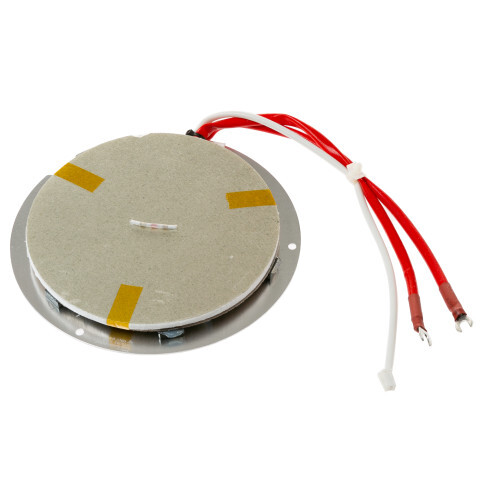

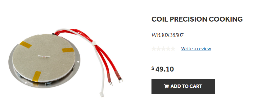

I am looking for a replacement burner for a Cafe CHS90XM2N1S5. Everything I see online as a replacement, doesn’t have the hole in the middle for the precision switch. Just wondering if anyone has that part number? I do not believe WB30X38507 is the right part number.
Based on the model number provided the manufacturer show the left front precision surface element to be WB30X38507
https://www.appliancepartspros.com/ge-coil-precision-cooking-wb30x38507-ap7034458.html
That is what I was showing too, but that part number doesn’t have the round cutout in the middle for the precision cooker switch that it needs.

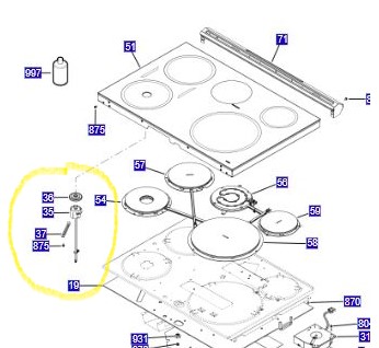

This was the element, the sensor is ref# 35, the grommet is ref#36, and the retainer is ref#37 in the part diagram…see link below:
https://www.ordergeapplianceparts.com/products/ge-appliances/electric-range/chs90xm2n1s5/610902?bomId=0&lang=en-US&sn=&snr=0&snt=0&contentId=610913#content=610913
I am looking for the heating element, but when I search that part number (WB30X38507), it does not show the heating element with the hole in the middle. The diagram shows it does, but when I google that part number everything shows up as not having the hole.
As shown in the manufacturer diagram, the parts are sold and replaced separately. You have to assemble the parts when received.
I understand. Below is what the diagram shows, but when you look up that part number (WB30X38507), the below is the image that it shows. It does not have the hole in it.

After extensive research, everything we have on this model says this is the part for your models left front burner. I would recommend you contact the manufacturer with your concerns and see if they have changed these parts for some reason.
Good morning,
Research finally paid off and the part number for the Precision cooking element for you Left front Is Ge WB30X35350 Coil Precision Cooking OEM Part.
Sorry for taking so long to solve this issue.
Thats it! Thanks so much!
