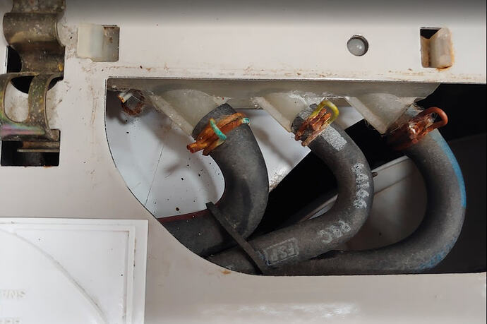

Need help removing cabinet on Kenmore Ultra Care
Brand:Kenmore
**Model Number:**110.82992300
Main Symptom:tub replacement

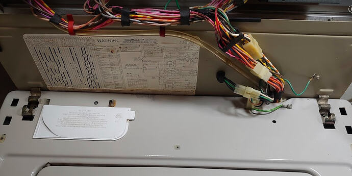

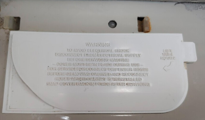

What happens & when: Cannot find any directions to remove cabinet on 3 dispenser Ultra care. No videos or manuals seem to cover the additional steps. There is a cover on the top where you can disconnect the 3 hoses, but do not want to damage anything.
You will remove the control panel and once it has been removed, there will be 2 clips to remove to take the cabinet off. Before removing the cabinet you will disconnect the hoses to the valve. Then you can remove the cabinet.
I see. that, I do understand, but my washer has the 3 dispensers and it appears that I have to disconnect the 3 hoses at the 3 way valve also that is under the white plastic plate. Since there is , or appears to be, no manuals that specifically show this in them , or on youtube videos, for this particular situation, I just want to be careful. With the bleach, soap and fabric softener dispensers on the Ultra Fabric Care, that additional step is what concerns me, as the tubes on that valve could break off. And it seems it would be impossible to find one… Thank you for your reply. much appreciated
Is it just these 3 hoses that need to be disconnected, and the cabinet will come off?
Yes, that would be correct.
thank you. It is all good now… machine was pristene after all these years of use
