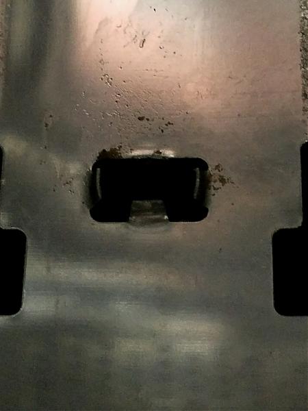

I had no luck removing our vane in spite of all the helpful posts. The mystery of how to release the locking tabs eluded me. I finally cut the vane off with a Dremel tool, and am attaching two pictures in hope they’ll help in the future. One pic of the tabs in the up position, and one of them flattened out in preparation for installing the new vane.
I don’t believe I would have been able to flatten the tabs using a screwdriver as suggested. The limited angle of attack allowed by inserting the screwdriver in the top hole and the force required to do so, working blind, would have been very difficult.
With the Dremel the vane was off in under two minutes. That’s the way to go in my book.
