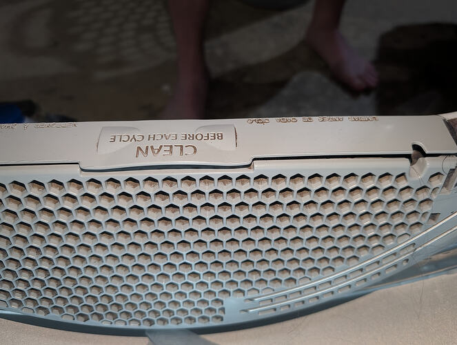

I need help identifying a part.
Model Number:ptd60ebsr1ws
cant decide if its WE01X33121 or WE01X33120
You can use either of those part #s, the only difference between them is that WE01X33120 comes with the gaskets/seals and the sensor rod, basically the entire duct trap assembly.
