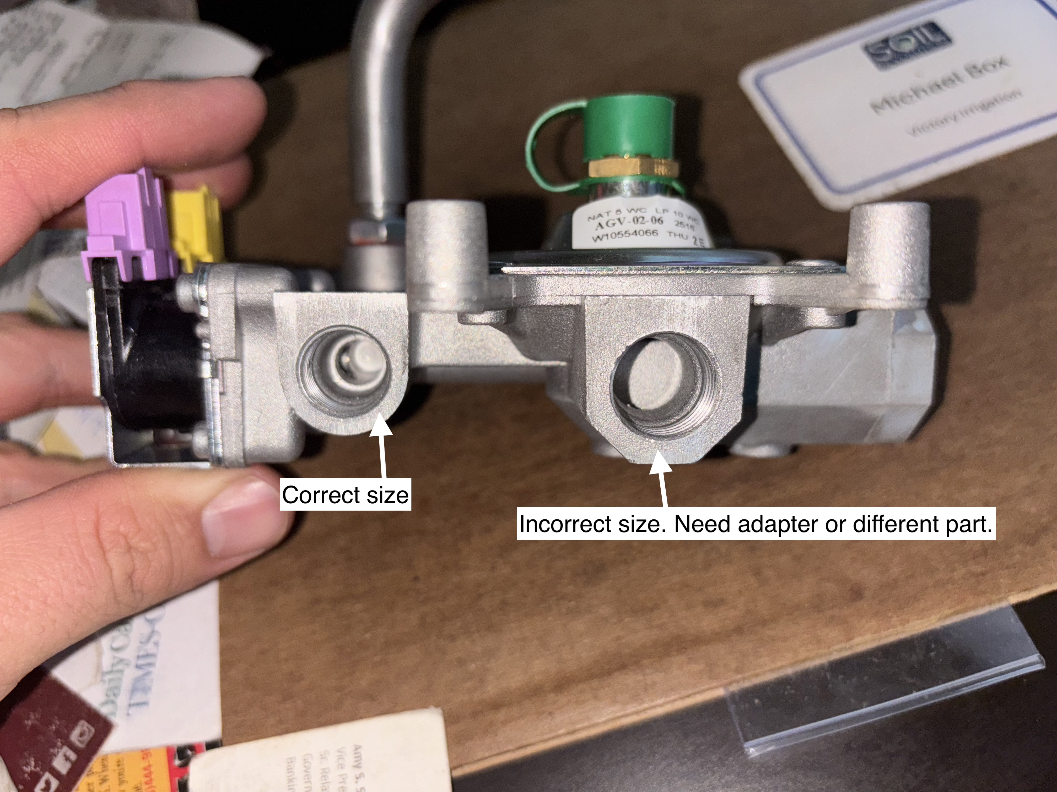

Need an adapter for a Whirlpool range gas valve
Brand: Whirlpool
Model Number: KGRS202BSS1
Main Symptom: Faulty Valve and Pressure Regulator
What happens & when: Attempting to replace the Valve and Pressure regulator assembly using W10861656. There are two female outlet ports that run to the range and broiler on top of the valve. On the original piece, these ports are identical. The appear to be 3/8” flange fitting. On the replacement piece only one of these matches that. The other one is slightly large and seems to potentially be a M16 fitting, though I am not 100% sure of that. I ned either an adapter or a need valve/regulator but don’t know what that part would be.
Parts or tests already tried: W105554066
Looking at the parts list for this model, it would appear that the valve that you got is the incorrect one. Here is a link for the correct part.
https://www.appliancepartspros.com/whirlpool-regulator-wpw10602004-ap6023341.html
