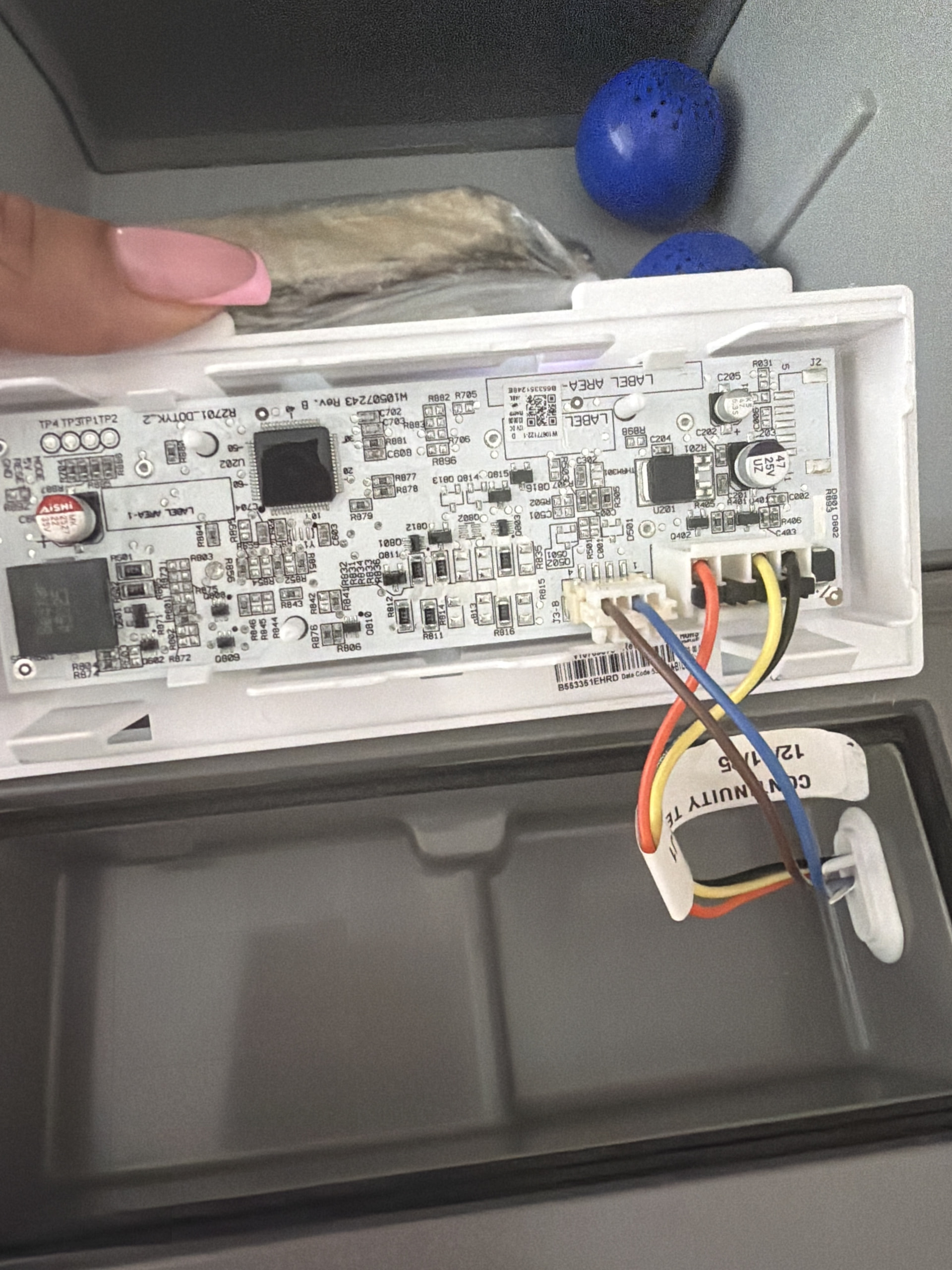

My refrigerator is making a noise and has an error code that keeps popping up
Brand:Kitchen Aid
Model Number:KRMF706ESS01
Main Symptom:Door Error Code
Error Code (if any):Yes red door open error code
Parts or tests already tried: I and installed this part Whirlpool W10815669 Refrigerator Door | Genuine OEM Part
And I’m still getting this error. And the fridge is still making a noise. Please help
Can you tell me what kind of noise and where it seems to be coming from?
The noise is coming from the refrigerator. It’s a red error code. Attached is the photo of the error code.
What does the noise sound like, rattling, popping, scraping, loud, soft, continuous rhythmic
The noise sound like an alert, like if the refrigerator door was left open and it’s alerting to close it. It’s alarms 3 times before stopping, and maybe going off again 19 mins later.
ok so it’s a reminder tone
I meant 10 mins later.
Yes it’s like a reminder alarm.
Where did you get the door? is it OEM? Have you checked the door switch?
The door came with the refrigerator. Only part I have changed since purchasing this refrigerator is part mentioned: Whirlpool W10815669 Refrigerator Door | Genuine OEM Part
In which the refrigerator was making this noise before I purchased this part from this company, upon watching a YouTube video I opened the part on the refrigerator attached here and realized all of the wires were corroded and and was in really bad shape. This part comes as a new wire system that favors a motherboard, along with new door.
now that we have that changed, the noise wand error code still hasn’t stopped going off. So I’m not sure what to do at this point, to get this fixed.

I’m not sure where I should find these functions, SW1 and SW2. Can you tell me where to locate these functions?
Where do I find this?
find what? those are the buttons on the control board
I do not see those functions. Attached is a photo of the control board
they are on the user interface of the board where the display is
I have sent you a photo of this showing the back of it, it does not look like the photo you sent with Sw1 and Sw2
