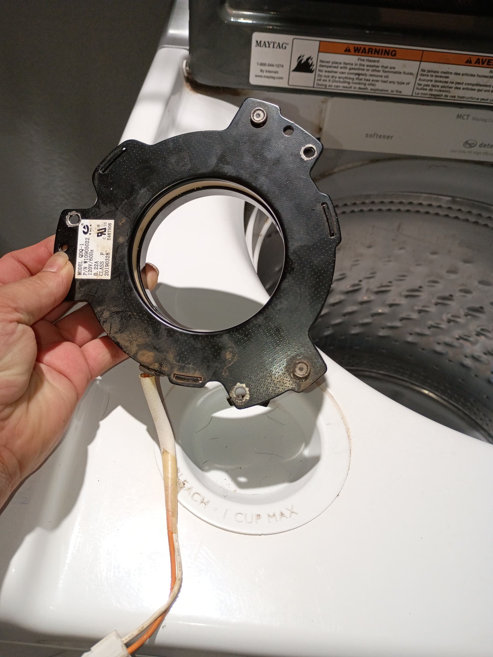

Brand:maytag
Model Number:MVWB835DW4
Main Symptom:doesn’t wash gets stuck in sending and codes F7 and E5
What happens & when:2 weeks ago
Error Code (if any):f7 & e5
Parts or tests already tried:shift agitator
Brand:maytag
If you’ve already replaced the clutch coil and the clutch assembly moves freely on the pulley shaft, the next thing to check is the wiring from the main control to the clutch coil. Test those wires for continuity. If the wiring checks good with no damaged spots, then the main control is the part that’s failed. Here’s the link to the main control info page just in case. W11400681 Electronic Control Board | Genuine Whirlpool OEM In Stock
