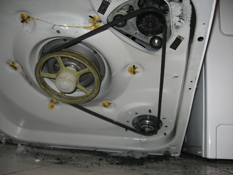

So the pulley on the motor got ground in half. I am guessing it was the belt slipping ate through it because I can turn the drum and pump by hand easily so I don’t thing something is bound up.
The motor also operates so I think that it is ok too.
So I want to try and just replace the pulley and the belt. Part Details - WHIRLPOOL Pully/motor, part number: AP4024152
Can anyone tell me how hard it is to get the pulley off ? I tried prying the plastic clips out but it doesn’t slide off so I am thinking it’s pressed on there ?
Any help would be great 5 buck for a pulley vs 130 for a motor would be great.
This is a fairly common problem with these motors and pulleys. Theh pulley is fiber glass and it just disintergrates.
Maytag has pressed the pulley onto the shaft. You will need a gear puller with at least a 3" spread to get it off.
Getting the new one on is a bit of a procedure.
  1. Take the cover off of the rear of the shaft and use a socket to “backup” the shaft so it does not move when you have to tap the new pulley on.
  2. With the hub fingers on the pulley out, position the pulley on the motor shaft and push until the spine meshes with the pulley
  3. Gently, and I do mean gently, use a 1/2" deep socket to tap the pulley onto the shaft.
Replace the cover and you should be all set. I don’t know why Maytag made it this hard, they just did.
Thanks for the great info ! Are you totally removing the motor when doing this ?
Yeah it’s odd that they used a metal pulley on the pump and a fiberglass one on the motor.

Yes, take the motor off, secure it in a manner that will not damage it and take a lot of care with this. The motor comes out pretty easily.
Got it fixed thanks for the help !
I cut the pulley in half with a Dremel to get it off and tapped the new one on with a socket like suggested.
There isn’t much for a tensioner I would guess that’s why these things are failing.
Next time I hear the belt squeaking I will get a new one right away.
Well neat, nice going and glad you got it to work and saved all that money from not having to buy a motor.
This happened again! This time it was not as catastrophic but I still need to replace the belt and pulley again. I didn’t even get any squealing this time. The drum just stopped turning and after getting the water out and looking at the bottom of the washer I can see the pulley is badly worn. This time I think I need to come up with a better tensioner than what they are using.
At least this time I caught it before the belt disintegrated so there’s not a big mess to clean up like last time.
This appears to have been a design flaw with these models, glad you can repair it and keep it going.
