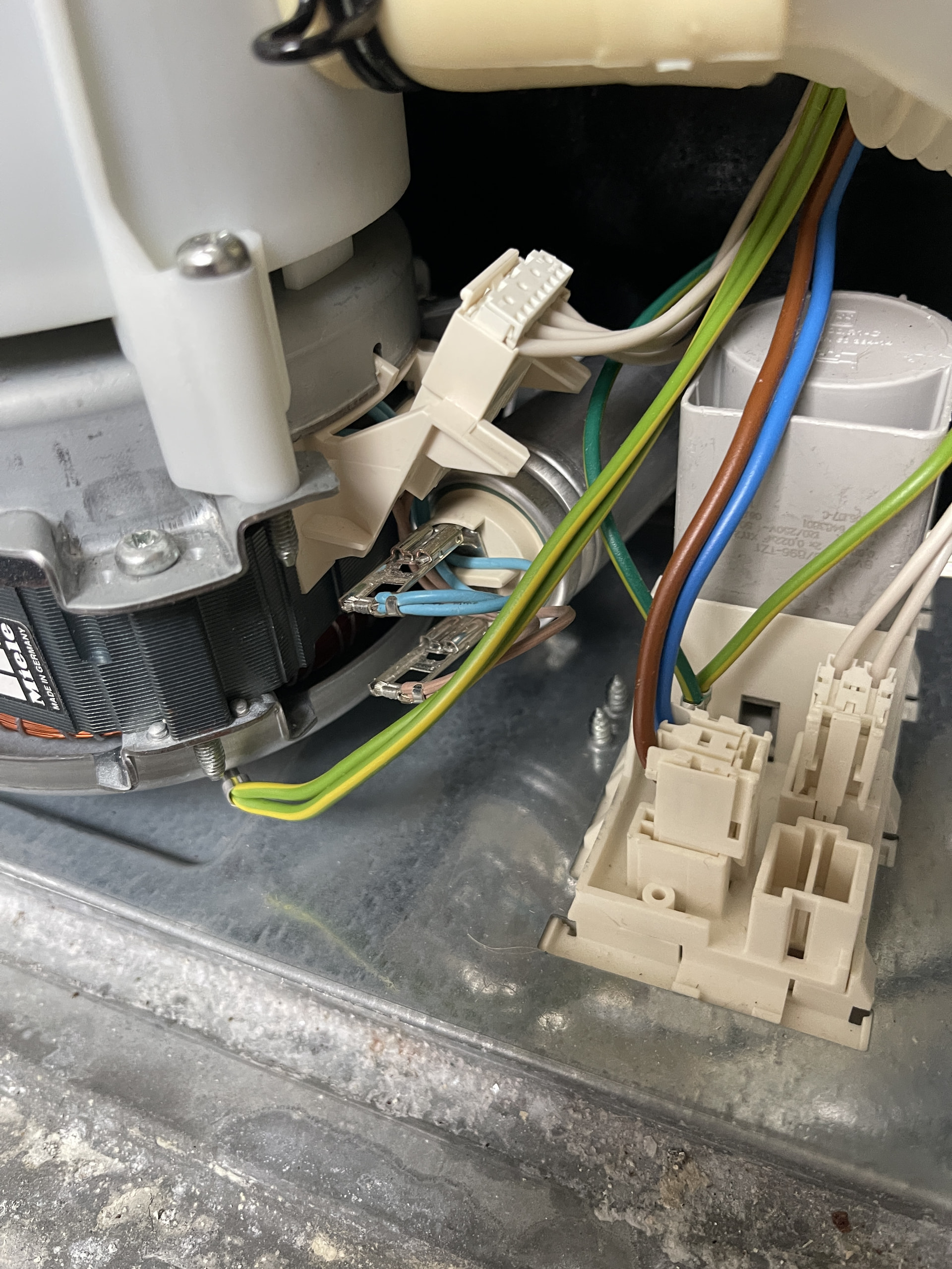

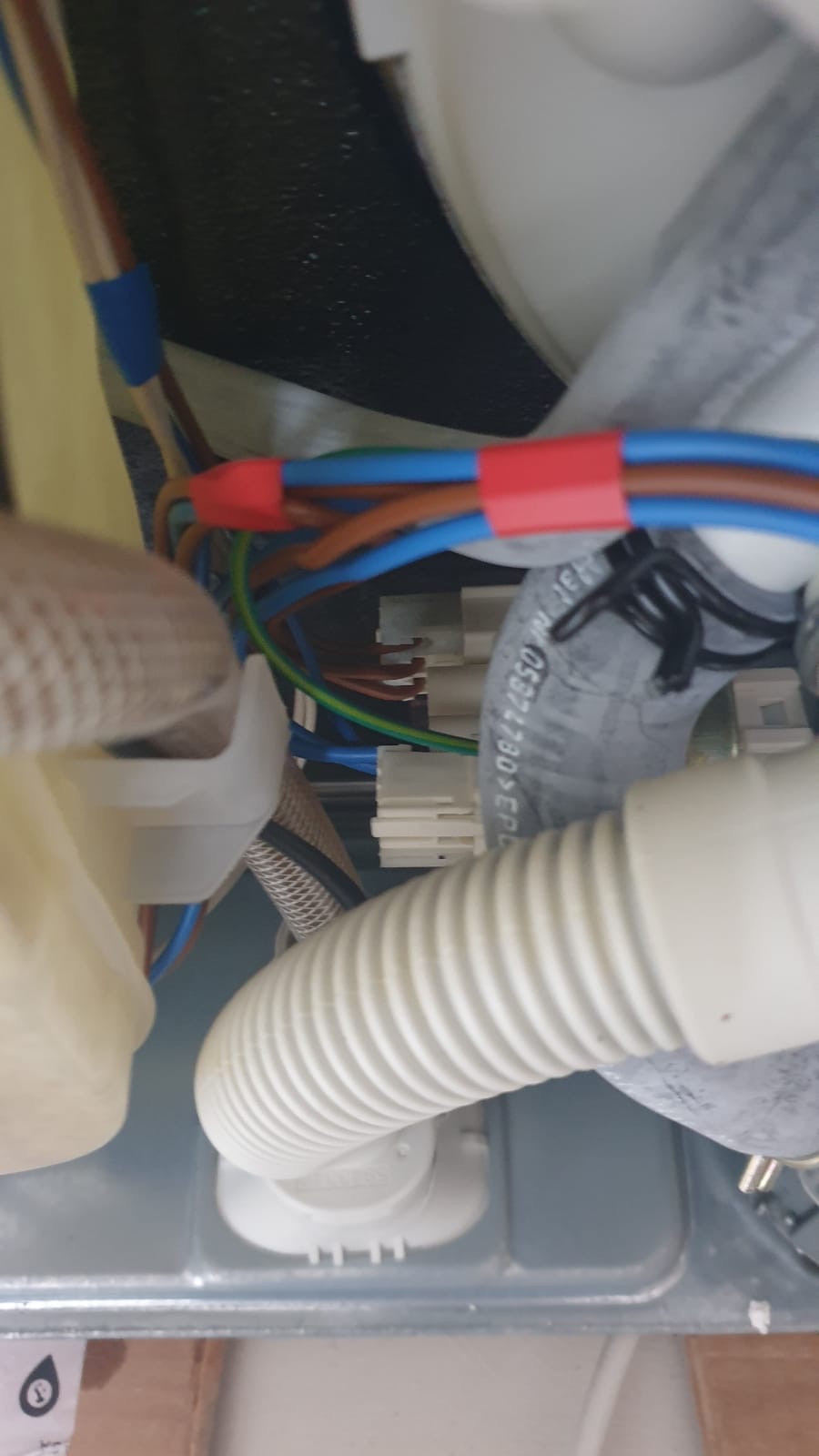

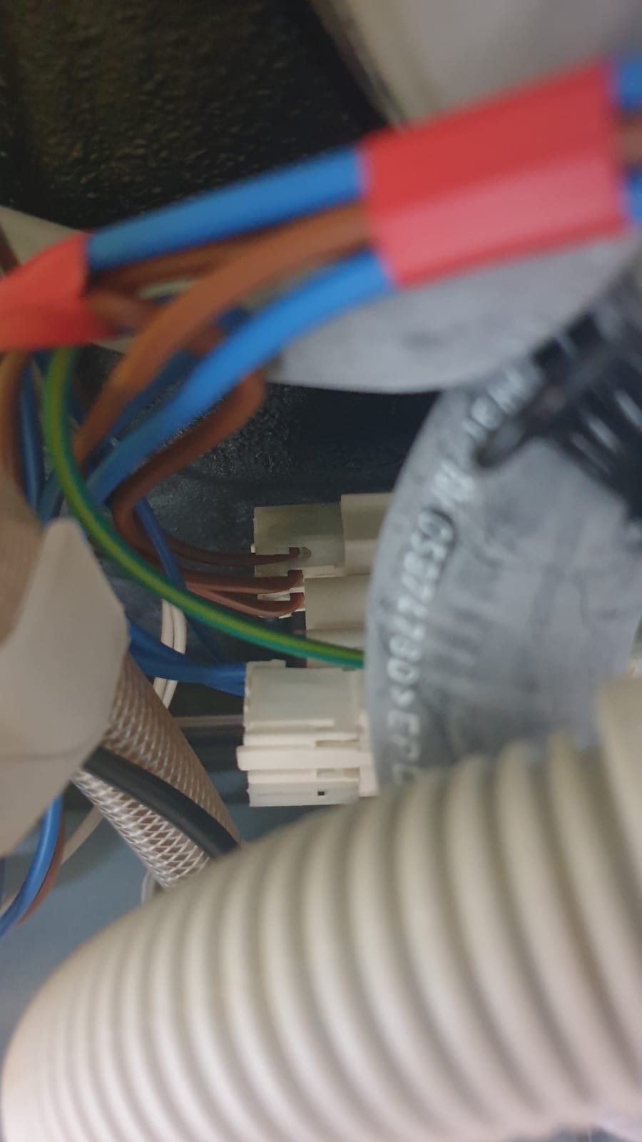

Did you try the test where you unplug the recicrc pump and run it
which wires do I disconnect to run the test ? please see pictures
Sadly we don’t have any further literature on Meile appliances. I do noy have a wiring diagram to reference
i found this diagram in the front door of my machine. C6 is the circulation pump
Yeah that’s the most basic wiring diagram I’ve seen no wire colors to help identify anything
if i disconnect all wires going to the circ pump, would that be damaging for the machine?
white gang plug is motor connector and blue and red is heater
so i disconnect the white gang plug that is on the lower right side of the circ pump? Do i disconnect earth as well?
No the ground can stay. You understand I am basing this off experience with other dishwashers. We have no one in house who has actually serviced your model or brand of dishwasher
i also found this wires on the left side of the circ pump…see pics
it seems all these cables go to the heater…they are marked with blue and red tape
i disconnected the white gang cable and run the program. machine went thru the usual cycle - pumping the water out, filling the machine with the water, and then at the time it usually blows the RCD it didnt happen this time. I heard some clicking noise as if machine was trying to activate something ( i assume circ pump) , i waited till 4 minutes as machine was not doing anything just clicking at intervals.
Am I safe to assume it is the circ pump that has to be changed?
Yes that would be my suspicion
