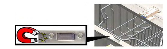

Mid cycle stop- sometimes soft reset sometimes hard reset (breaker)
Brand: bosch
Model Number:
SHPM65W56N/11
Main Symptom: mid=cycle shutoff
What happens & when: reset then resume cycle. Part 2. Ordered new board from you that shows E:06 code.
Error Code (if any): E:06
Parts or tests already tried: This a new board from your company. Old board did not show any errors.
This error indicates a door sensor issue, which could be a couple of things. A quick check would be taking a magnet and placing it just to the left of the latch on the door (as seen in image). With the door only open enough to have the magnet in place, will the dishwasher stop showing the error code and start? This can help identify where testing may need to go.
I took a chance and ordered a door sensor. Problem solved. Thanks for your help.
