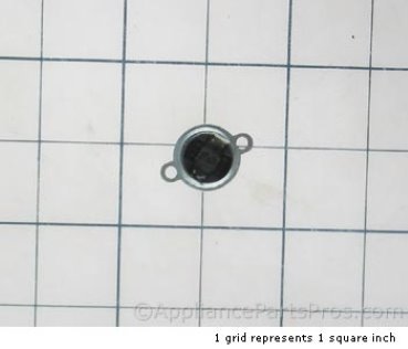

Remove the top grille and open the control panel. Check for continuity the magnetron thermal cut-off (#14 on the diagram). If this part is not accessible through the control panel opening then you have to remove the microwave from the cabinet.
If the thermal cut-off is open then it has to be replaced and you have to make sure the cooling fan is working.
If the thermal cut-off is good then the problem is a bad control board.
  • The part number for the thermal cut-off is AP4060517
  • The part number for the control board is AP4062549

Hi Gene, today, I opened the control panel side, however, I could not locate the TCO as it was shown in the little picture (#14). I looked over and over again, the only mentioned TCO is on a yellow wire which connected to a 6 wire plugs on the control board, the yellow wire labeled (yellow) TCO H.D, then there are other 5 wires on the same plug which said like (red) COM MGT, (black) Geared Motor etc … the other end of these 6 wires were connected to a rectangular blue plastic part with one blank button, this button seems to operate the open and close door and turn on and turn off the light inside the microwave. Other than that, I do not know where is the TCO part that you mentioned about. Would you please direct. Would you please tell me where the defected part near by? Is this right on the control panel or inside the cavity where it looks like the magnetron (#1) is located? Thank you very much for your clarification. Regards, Thu.
Thu,
It looks like a small tablet
and it is attached to the magnetron
Hi Gene, thank you very much again. I could not locate this part on the control panel, the magnetron looks big, it seems to me that it is inside the cavity behind the control panel. Am I right? I looked at the image of the TCO that you sent, it does not look like any attachment to the picture on the magnetron, so, it might be behind the magnetron that I do not see, am I right? For the TCO, it saw the 2 prongs, are these the ones that I need to put the meter to test for the open and close that you talked about previously? If my assumption is correct as above, then I would like to ask you how do I bring down the microwave oven from the cabinet? I could not see how was it hung? Please give me tips. Thank you very much again. Thank you for your patience to the novice. Regards, Thu.

Hi Gene, I took down the microwave oven from the wall, the back is covered with metal piece, I looked around the magnetron, but no where around the magnetron that I can see the small tablet being attached that you are talking about. How can I take out the magnetron? Can I just pull it down? Is the small tablet inside the “square with lot of holes” in the middle of the magnetron? I saw some round thing inside the middle session, but the diameter is bigger than the tablet in the picture that you sent me and I do not know how to access to it, it seems to be built in. Where this small tablet will be? outside the magnetron or inside? Please direct me where and how can I take out this small tablet out to test? Thanks again. Thu.
It should be screwed to the magnetron exactly the way it’s shown on the diagram.
Hi Gene, I took down the oven, then took out the magnetron, examined all over the magnetron, took out the top, still, nothing like the tablet being attached as you said! Looked around all over the microwave oven, found 3 same “tablets” that looked exactly like in the pictures. Tested all 3 of them, one is bad, these are no where attached to this magnetron. Well, the one which is bad actually I did not have to take down the microwave and open so many screws and covers (just to get to the magnetron). I ordered one TCO fuse today, hope that will fix the problem. Anyway, I spent much time to get to the magnetron, but well, it is OK if my microwave oven will work again. I am not that happy yet, but anyway, thanks Gene. Thu.

Hi Gene, Why do you say that? I followed exactly what you told me, you said the TCO is attached to the magnetron that is why I tried to get to the magnetron to find that TCO, but it is not there. Now, I found the failed TCO which is right in behind the control board. Anyway, I received the TCO fuse today and replaced it, however, the control board is still not lighted up, but the fan is turned on without any effective button available to turn it off, since the turn off button is on the control panel and the control panel does not work. So far, only the light when the door is opened turned on and the fan turned on when the microwave oven is plugged into the wall. I thought you sound so certain that if the TCO failed, then replace the TCO, then it will work and if TCO worked, then the magnetron is bad. Anyway, sounds like I am in the road block now unless someone know what else it might be. Can it be the control panel itself? Is there something else I can test? or I just have to simply give up and return the TCO to the seller? Any advise? Thank you. Thu.
Thu,
I said that because you did not have to take apart the magnetron. Now I do not know what is condition of the magnetron and it can be dangerous to use it. The TCO you replaced is for the exhaust fan. It is very different and it should be normally open. The TCO you bought is normally closed and thats why the fan had turned on by itself.
