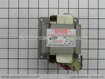

I removed the panel and found the high voltage transformer. Silver, rounded capacitor looking object. Unplugged the white wire and red wire and hooked it up to my voltage tester and with the microwave set for two minutes, the voltage started at 3.6 and went down from there in a matter of seconds. I don’t know what voltage we are looking for?
Kyle
Kyle,
This is how the transformer looks like:
Be very careful because there is VERY HIGH voltage inside the microwave. If you do not feel yourself comfortable working in a such environment it’s better to hire a pro to do it for you. You can buy a new microwave but you can not buy a health.
