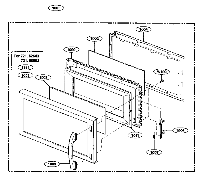

I have the same problen - broken handle on Kenmore 721.80599402. Sears wants 25 $ for handl , but how on Gods earth do I get door apart.
Any help is greatly appreciated!
[QUOTE=johnstaleyCLT;90821]I have the same problen - broken handle on Kenmore 721.80599402. Sears wants 25 $ for handl , but how on Gods earth do I get door apart.
Any help is greatly appreciated![/QUOTE]
According to the diagram the design of the door is pretty similar to the door shown in the clip on the page 2 of this thread.
