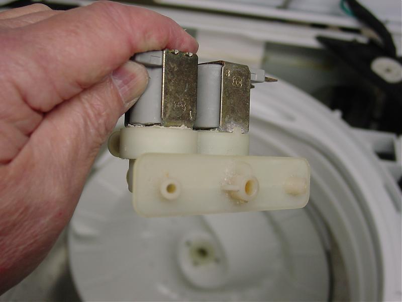

Mark I’ll post some old pics of the dispenser fill valve if you have not already removed. I would replace that assembly. From reading the post again “” [COLOR=black]5. Pressed Wrinkle Control key, heard humm but water was not diverted to the Fabric Softener reservoir as verified by dry paper towel.“”[/COLOR]

[COLOR=#000000]Are you sure the Washer Lid is not bowed? I forgot to ask that question. See the last pic. Make sure the dispenser fill ports line up with the water channels to the reservoir’s. [/COLOR]
I still lean toward a valve assembly replacement…I feel you nailed down the issue but if you want to give it a try… just work safely with 120VAC.
3 pic limit per post wiil show additional Dispenser Valve pics.
Good luck Mark and let us know how it goes…Dick
Bleach and Softner dispenser valve 2.JPG (44.6 KB)
Bleach Dispenser.JPG (28.2 KB)
Dispenser valve assemble 1.jpg (32.4 KB)
More Pic’s
Last Pic center port is water inlet from washer inlet valves via short black hose.
Dispenser valve assemble 2.jpg (52.3 KB)
Dispenser valve assemble 4.jpg (34.0 KB)
Dispenser valve assemble 3.jpg (38.2 KB)
