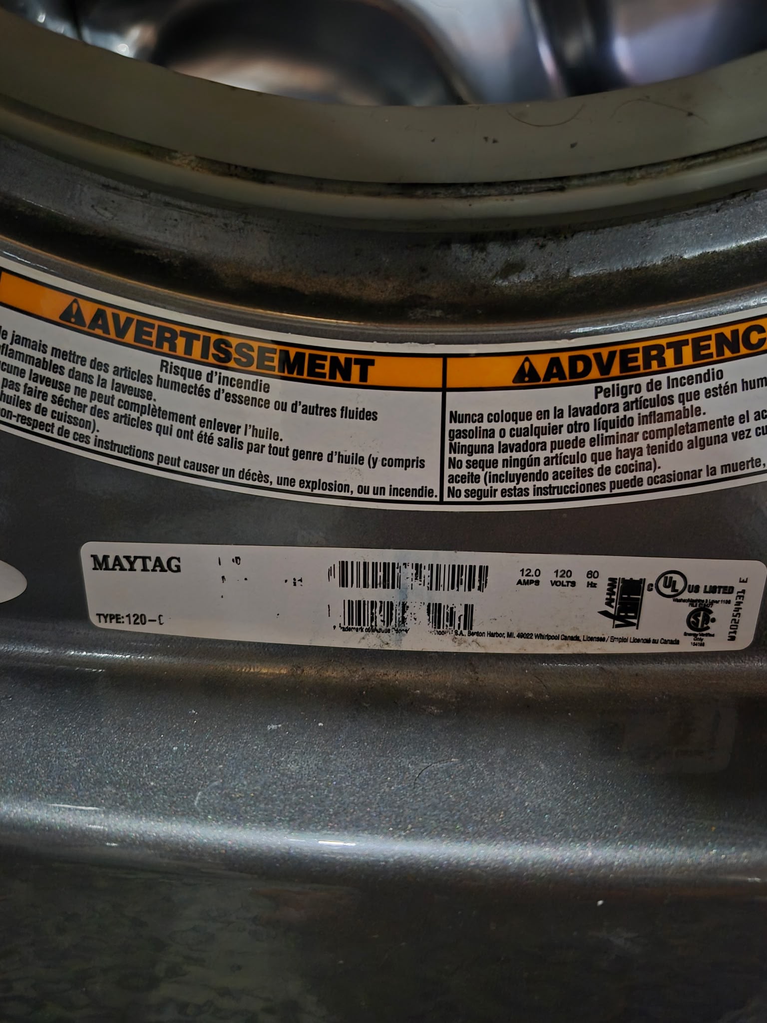

Main Symptom: machine doesn’t run
What happens & when: maytag washer just shuts off when trying to turn the dial and doesn’t run cycles . What could be the issue
Photos / video link: https://vimeo.com/1200789977?share=copy&fl=sv&fe=ci
Please send the model number so i can better advise you
Model number is faded so cant read from the label , however i have attached its video in the original post
